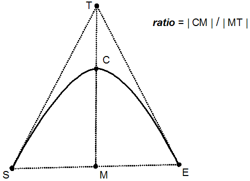

  • ratio (double) –
    Parameter that defines the created conic curve segment “altitude”. Consider the segment that connects the tangents’ intersection point with the midpoint between the start and end points of the curve. If the length of this segment is used as the unit length, then the ratio is defined as the length of the portion of the segment that connects the midpoint with the point where the segment is intersected by created curve (see figure below). Valid values for ratio are in the range 0 to 1. For the value of 0.5, the conic curve is a parabolic segment. For the values between 0 and 0.5, the conic curve is an ellipse. For the values between 0.5 and 1, the conic curve is a hyperbolic segment.
