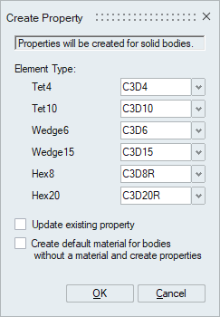

Description:
This tool will create property for the solid bodies based on the selected Abaqus element type.
  • Material should be assigned to the bodies before creating property.
  • Once the property is created, it can be reveiwed using the Abaqus element type column in the assembly browser.
  • Update existing property: It overwrites / assign the property based on the user selected Abaqus element type.
  • Create Default materials for bodies: If the material is not assigned to a body, default material will be created, and property is assigned based on the user selected Abaqus element type.
