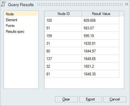

Node
Node option will display and export the selected node id and its results value in dialog.

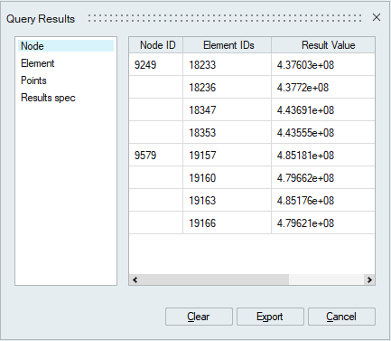

If the averaging method is "Not averaged", it will display the selected node id with its element ids and the result value of the selected node in those elements.
Note: It is applicable only for h3d results and results imported using new reader.

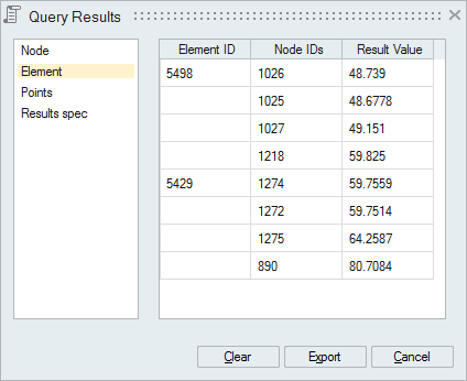

Element
Element option will display and export the selected Element id with its node ids and its results value.
Note: Results value displayed in the dialog, based on the current display results component.

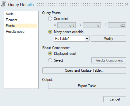

Points

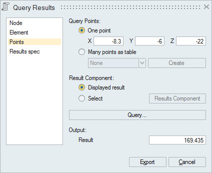

One point: The results value will be display in the Query Results dialog, based on the given single XYZ value.
Many points as Table: For many points created in the Field table dialog, the results value will be updated in the Field Table dialog. Exporting the table values performed in Field table dialog itself.
Results values for Points option will be calculated using the displayed results or using the results component which we selected.

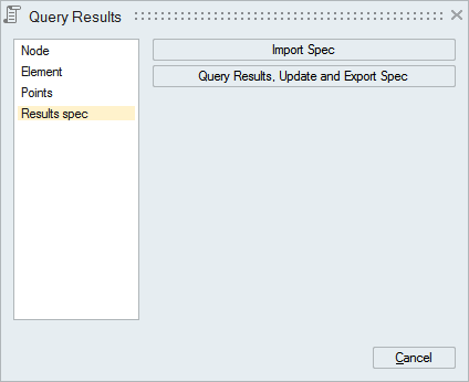

Results spec
This option will take results spec as input file (xml file which contains results component min and max request definitions) this will calculate the min and max for request component then it will export results as xml file
