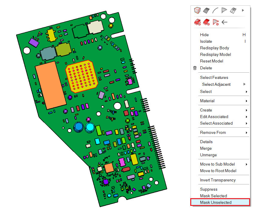

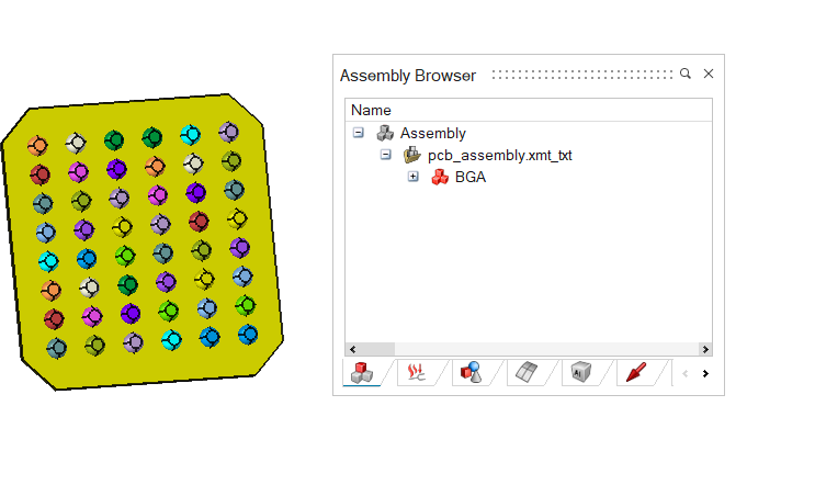

In the below example, if users want to work with BGA and its associated bodies, select those bodies and click Mask Unselected to mask all other bodies.
  • Input
  • Output

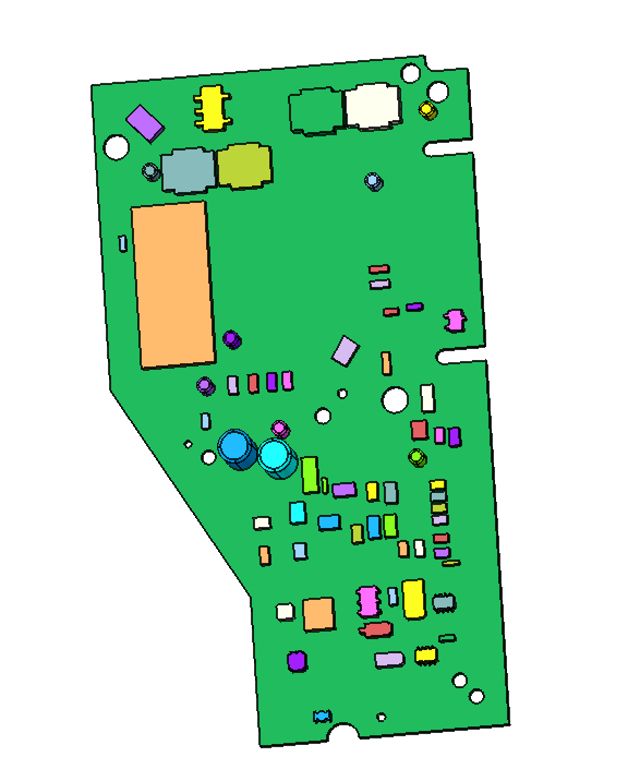

    Now it displays the interested bodies alone in UI.

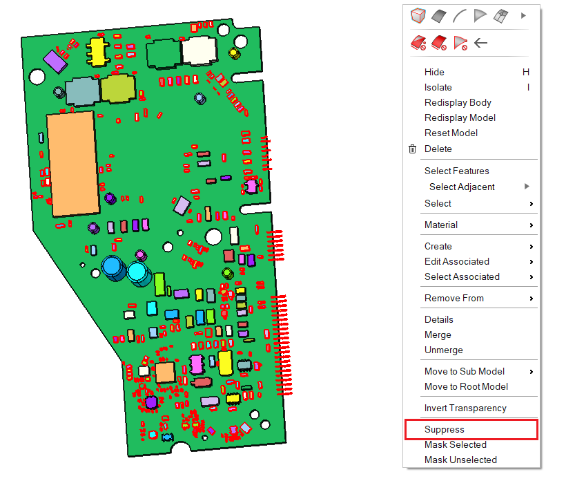

Input
In the below example, bodies not needed for the solution can be removed permanently by suppressing them.

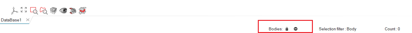

Status bar
‘Mask mode’ and ‘Suppress mode’ icons are shown in the status bar when a body is masked or suppressed. It helps to switch between the display mode and shuffle the bodies to make it a working set and vice versa.

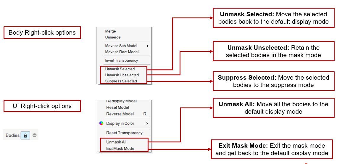

Mask mode
Following are the right-click operations supported in mask mode.

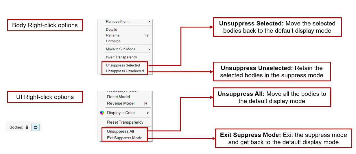

Suppress mode
Following are the right-click operations supported in suppress mode.
