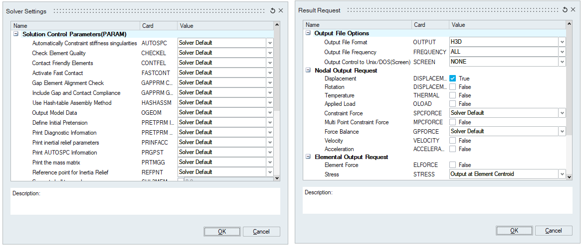

"Settings" dialogs are used to define Solver specific parameters, Output Request, Loadcase settings, Format and Execution options.

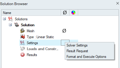

User can right click on "Settings" folder under Solutions or Load Cases to create required settings.
Following settings can be defined for Solution and Load case.
Solutions
- Solver Settings
- Result Request
- Format and Execute Options

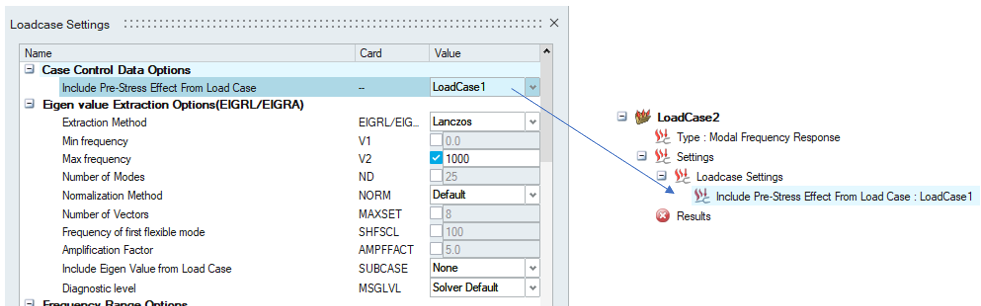

- Loadcase Settings
- Result Request
- Edited values will be highlighted in this dialog:
- On editing any parameter, it will be highlighted in Yellow.
- The modified parameters in solution / Loadcase will be highlighted in Blue.
- Some of the important parameters can also display in browser.
