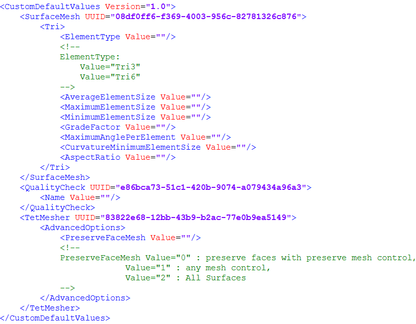

This is done by specifying the required default values in SimLabDefaultValues.xml which is available in Application settings directory\simlab (File > Preference > Application > General)
The SimLabDefaultValues.xml contains the dialog DOM with empty values as shown

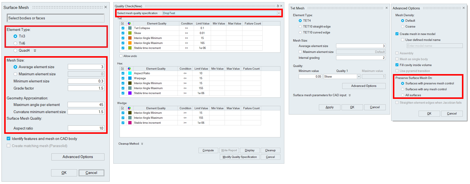

It is supported for few options highlighted in the following dialogs
  1. Mesh > 2D Mesh > Surface Mesh > Tri Element Type
  2. Mesh > Verify > Quality Check (New)
  3. Mesh > 3D Mesh > Tet Mesh

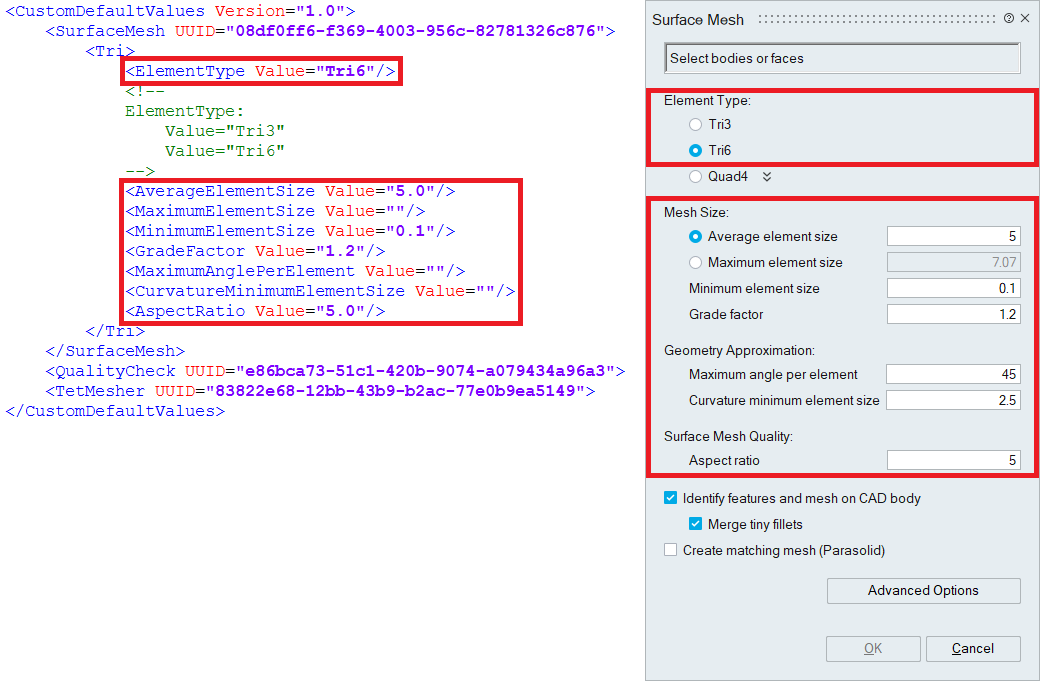

Example: Surface Mesh dialog values are customised.
