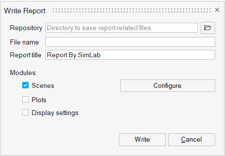

This tool is used to generate power point format reports for the modules in SimLab. Scenes, Plots and Display settings modules are supported for now.
Repository
The directory where the report and all the images related to the report are stored.
File name
Name of the report file to be generated.
Report title
Title for the power point presentation.
Modules
Initially, the scenes, plots and display settings modules are supported.
Reports to be extended to include Model Overview, Model Statistics, Quality Check, etc in the future versions of SimLab.

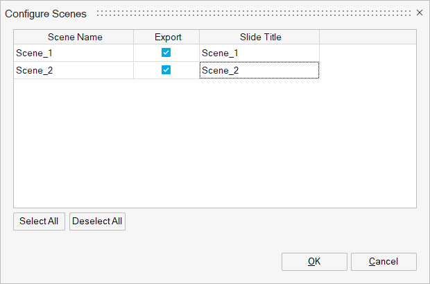

Scenes
Configure: This option is used to select the scenes to be included in the report and also used to provide the title for each of the scenes.
The size and orientation of the image depends on the current position of the graphics window. In future version, this will be handled implicitly.

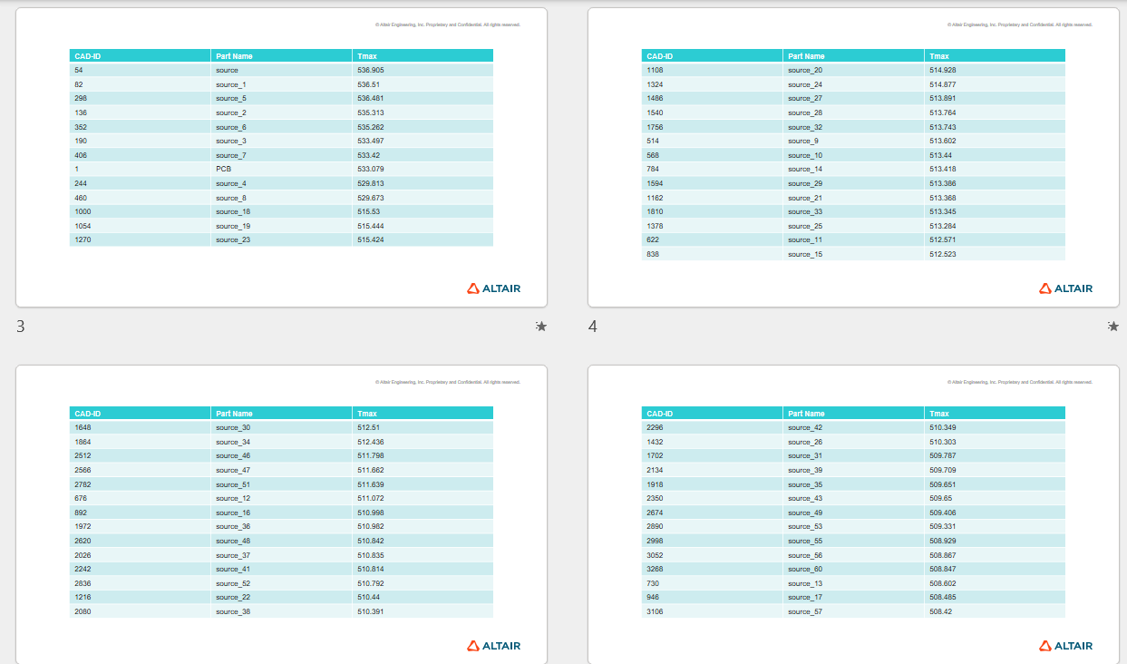

Sample Report

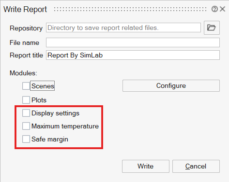

Solution Specific Modules
This is undergoing beta testing. Solution-specific modules are introduced for the Electronics Thermal Solution.

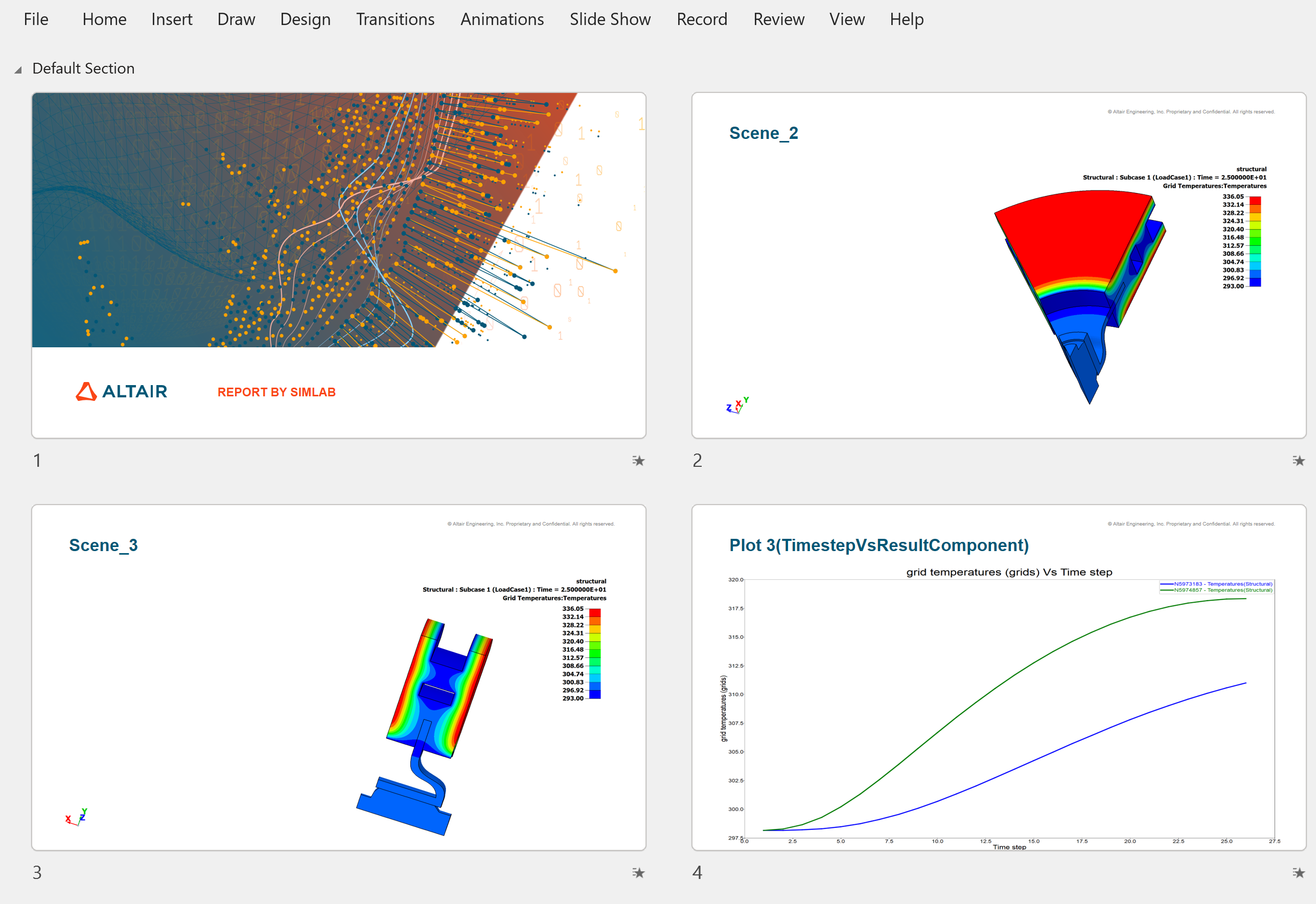

Sample Report
