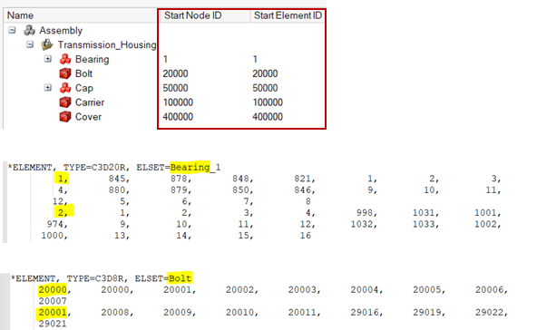

Start Node ID / Start Element ID
The Assembly browser contains columns to assign the desired start node and element IDs for the models / sub-models / bodies. The bodies get numbered using these values before writing the solver input file (Solution Name > Right Click > Export Solver Input File). It helps to always export the solver input file with the predefined ID ranges.

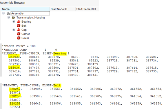

Solver input file exported without setting the desired Start Node / Element IDs in the browser columns:
Solver input file exported by setting the Start IDs:
The membrane elements (defined in the Sets) will follow the assigned element ID range of the associated body / sub-model / model in the assembly browser.
