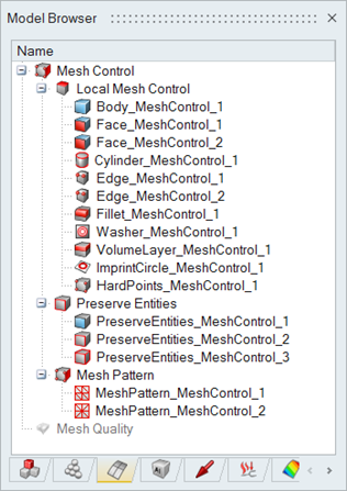

Meshcontrol
It displays the local mesh control, preserve entities, mesh patterns and mesh quality.

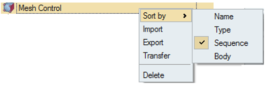

Right click options:
  • Right click on root folder - Sort by, Import, Export, Transfer and Delete.
    Note: Set the environment variable SIMLAB_MESH_SPEC_REPOSITORY=D:\Specification_Files and specify a common folder where all users can access to get the specification files. Click on Import option will always take you to the user specified folder in the environment variable.
  • Select Entities, Hide Entities, Move Up, Move Down, Empty, Duplicate and Delete.

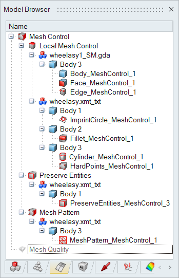

  • Sort by: This option list the mesh controls by name or type or sequence or body. Default display is sequence order.
  • Name: It lists the mesh controls name in alphabetical order.
  • Type: It lists the mesh controls as grouped objects like the options listed in mesh control dialog. The mesh controls within each group will be sorted.
  • Sequence: It lists the mesh controls in the same order as created.
  • Body: For each model, it sorts and list the bodies by its name and under each body it sorts the mesh control by its name and list all the mesh control associated with the body.
