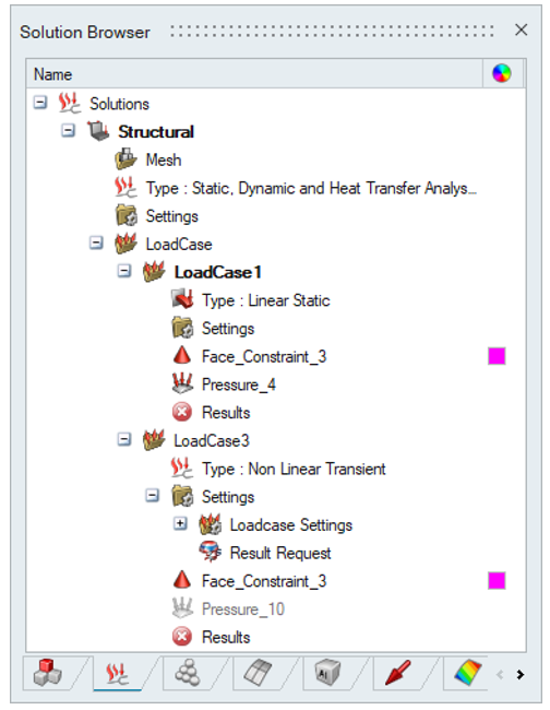

Solution
It displays Solution setup along with the FE bodies, loads and constraints and Results. Refer Solutions.
Right click options:
- Solutions > Right click:Sort and Display count options are supported.
- For Abaqus Drop Impact solution we listed the following option
- Create Properties By Element – Used to create the default properties for solid bodies based on element types.
