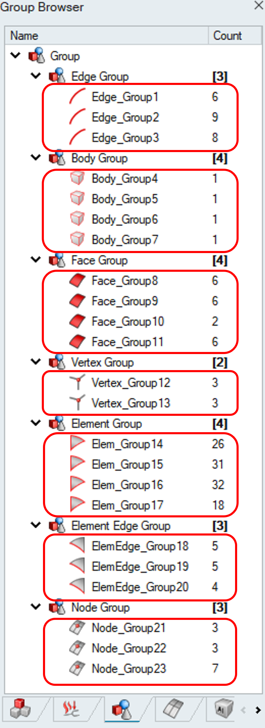

Group
It displays the groups based on the entity type. Successive click on the group will add/remove that group in selection in group color mode.
Click on the group name, group entities highlighted in the screen and the selected group added to the selection list.
Click on the group icon displays the entities on the screen with group color.

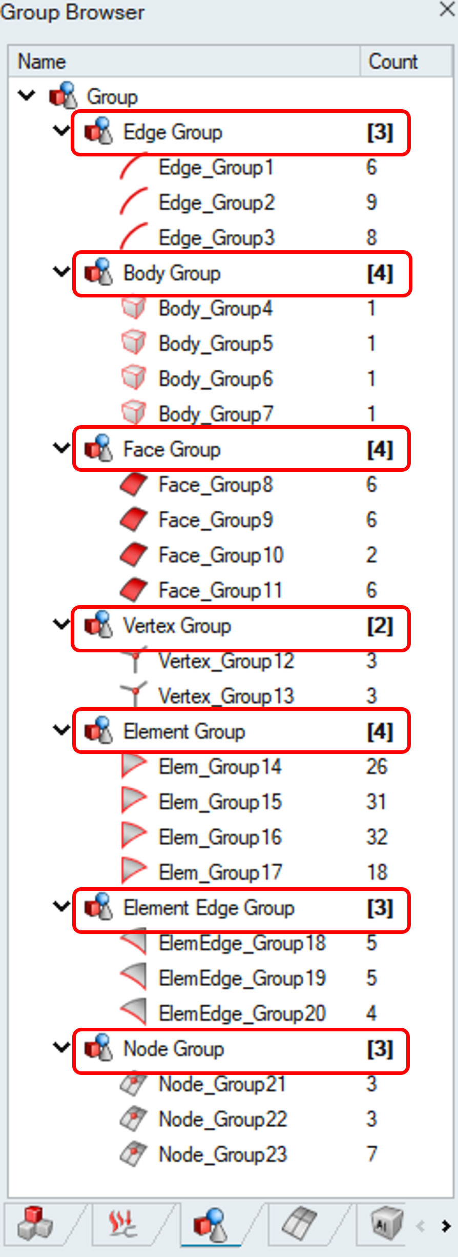

A “Count” column refers two things,
- Group count
- Entity count within the group
Group count refers to the total number of groups that have been created under each group type.
Entity count within the group refers to the number of entities within the single group.

- Group Root Folder: Create, Transfer, Modify, Boolean,Delete, Import , Export , Find and Replace Text, Set Random Color.
- Right-click options - Properties, Rename, Select and Deselect Entities, Hide Entities, Isolate, Empty and Delete.
