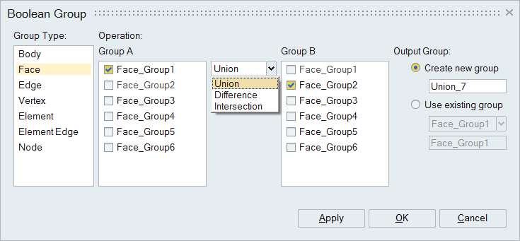

Boolean
Dialog Box
This tool is used to create / update existing groups by means of Boolean operations. The following Boolean operations can be performed between groups.
Union
This option combines entities of selected groups and creates a group out of it.Difference
This option identifies entities from selected groups which are in the Group A column and not in the Group B column and creates a group out of it.Intersection
This option finds out entities which are common to the selected groups (available in both groups) and creates a group out of it.Output Group
The output group of Boolean operation can be created by means of two ways.
- Create new group: A new group including the entities which come out as a result of Boolean operation with user specified name will be created.
- Use existing group: The entities present in the selected group will be deleted and the entities which come out as a result of Boolean operation will be added to the group.
