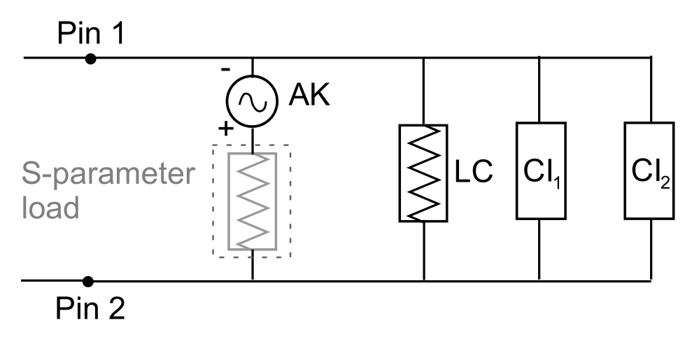

Parallel source (LC connected in series):
The example consists of the following set of elements:
- A parallel connected source where an LC load would be connected in series. The default connection orientation is used (positive terminal of the source is connected to the pin defined at the first terminal).
- An LC load is defined between the two pins.
- Two cable interconnections are defined between the two pins.
The figure below is an illustration of the connection between the two connector pins.

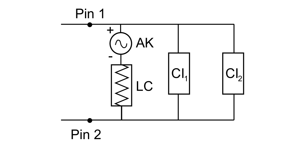

Parallel source (LC connected in parallel):
- A parallel connected source where an LC load would be connected in parallel with the source. The connection orientation has been reversed so that the negative terminal of the source is connected to the pin defined at the first terminal.

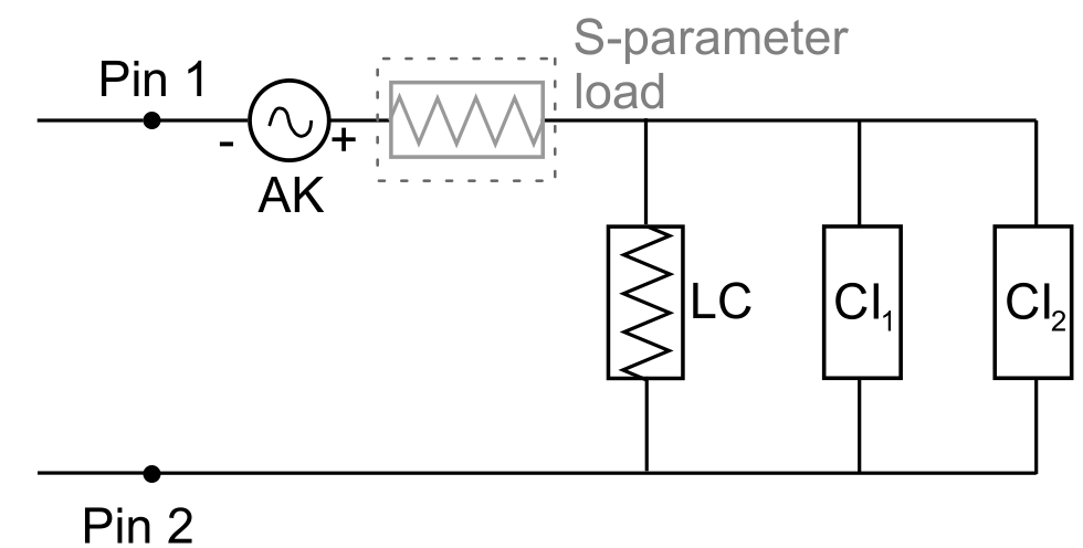

Series source
- A series connected source. The connection orientation has been reversed so that the negative terminal of the source is connected to the pin defined at the first terminal.

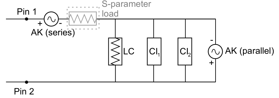

Series and parallel source
The last example is a more complicated example where two sources are added between the same pins. The example consists of the following set of elements:
- A series connected source connected to the pin defined by the second terminal of the source defined above. The default connection orientation is used (positive terminal of the source is connected to the pin defined at the first terminal).
