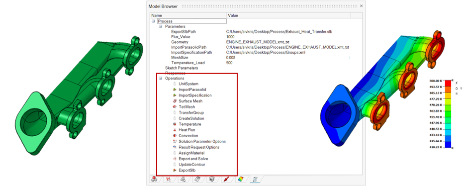

Parameter Browser > Process > Operations captures all the steps involved in the modeling process. These steps get stored along with the database. Users can do a quick study of the model by varying the parameters and recreate the process.
Example
Below, given an example (heat transfer analysis) where the process browser shows all the operations from CAD import to Results.

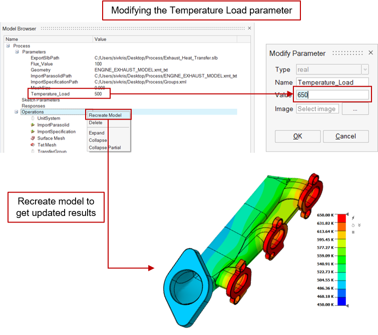

Output after modifying the parameters and recreate the process.
After recreating the process, each operation has its status displayed. The green tick mark denotes success and, the red cross mark denotes failure.

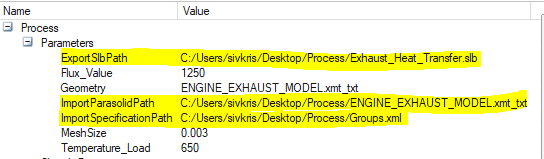

If any operation contains a path as input, it will automatically get recorded as a parameter. It will help the user change the path upfront if there is any need before recreating the process. The below-highlighted paths represent automatically created parameters.
