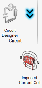

Note: For Transient magnetic solutions, usually a Circuit Designer is created and the usage of Imposed Current Coil is not common. For this reason, this load button is hidden:

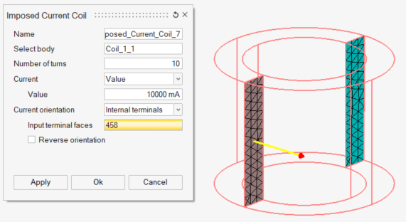

    • Internal Terminals: defines the current orientation in a closed coil (not cut by a symmetry nor periodicity). To define this orientation, Input terminal faces corresponding to coil body's internal face(s) have to be selected. As soon as this selection is done, a preview of the current direction is displayed through an arrow. It is possible to change the direction through Reverse orientation checkbox.

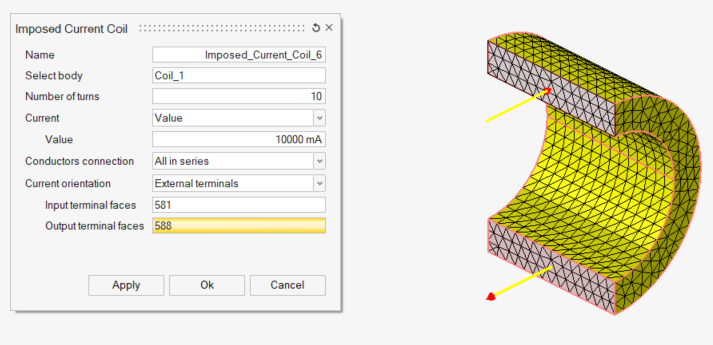

    • External terminals: defines the current orientation in a coil which is not closed (cut by a symmetry or periodicity). To define this orientation, Input terminal faces and Output terminal faces have to be selected.

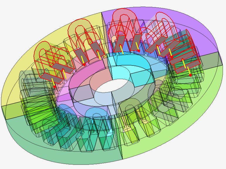

    → If there are already created Imposed Current Coil entities, the associated previews become visible on the graphic. It allows an easy definition if the device contains several coils.

    1. Internal terminals is selected when the coil is closed and is fully represented (not cut by symmetry or periodicity).
      1. Select face(s) in Input terminal faces corresponding to coil body's internal face(s).
        → As soon as this selection is done, only body's internal face(s) are visible and a preview of the current direction is displayed through arrow(s) starting from the Input terminal faces
      2. It is possible to reverse the direction through Reverse orientation checkbox and see the preview updated.

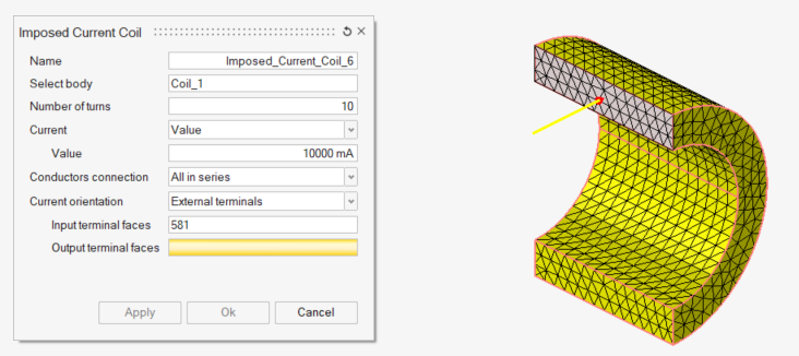

    2. External terminals is selected when the coil is not closed (cut by symmetry or periodicity)
      1. Select the Input terminal faces
        It is the face(s) through which the current enters
        → A preview of the current direction is displayed through arrow(s) on the Input terminal faces
      2. Select the Output terminal faces
        It is the face(s) through which the current exits
        → A preview of the current direction is displayed through arrow(s) on the Output terminal faces

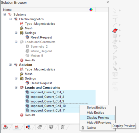

Display Imposed Current Coil preview
Adding to the preview visualisation during Imposed Current Coil creation and edition, the command Display Preview allows to display Imposed Current Coil previews at any time.
For that, right-click on the Imposed Current Coil entities and click on Display Preview command.
→ All the selected Imposed Current Coil entities previews become visible on the graphic:
The command Hide All Previews in the same contextual menu allows to hide the preview and reset the graphical view.
