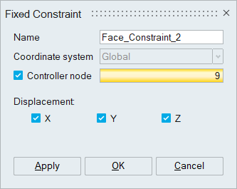

Fixed Constraint
Analysis > Fixed Constraint
Fixed
This tool is used to define fixed displacement and also the controller node for FSI analysis.

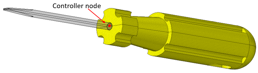

Controller node
  • It is used only in FSI analysis. We can enable FSI analysis by turn ON "Mold/Insert Stress Analysis" in solution parameters dialog.
  • SimLab can model the part inserts that are held in place with constraints that are automatically removed when the flow front reaches the vicinity of the constraint.
  • The user must select a controller node in addition to the face selection and the constraint will be removed when the filling front reaches the controller node.
