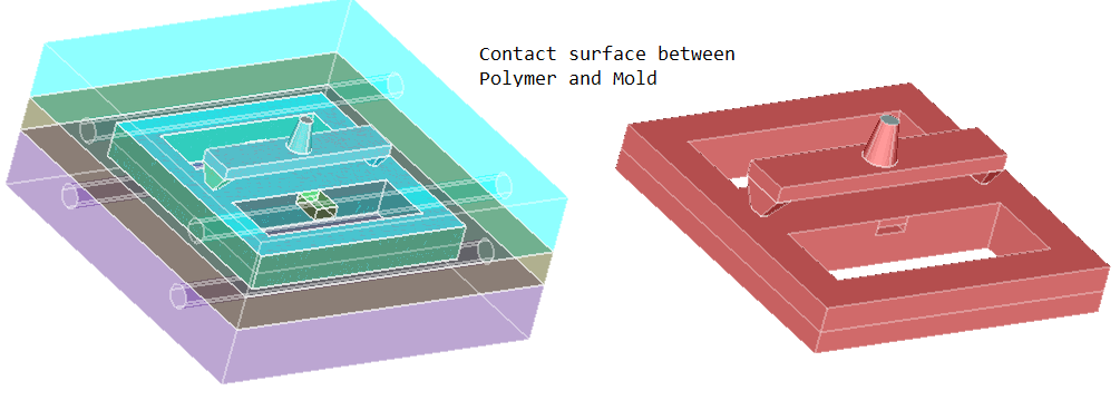

This tool is used to define the contact surface between Polymer and Mold for effective heat transfer. It is only used for Models with Mold.
Steps
  1. In Polymer Bodies: Select all Polymer bodies.
  2. In Mold Bodies: Select all Mold bodies.
  3. Specify Heat transfer coefficient between 3000-5000. The unit for Heat transfer coefficient is W/m^2K.
