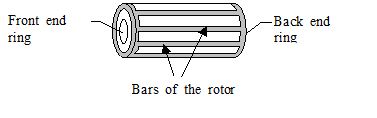

The squirrel cage of an asynchronous machine is an assembly comprising metal bars connected to one another, in cylindrical form, by two end rings. (see figure below).

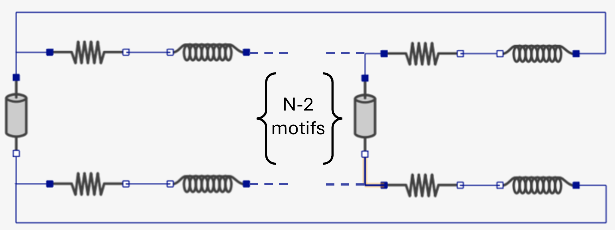

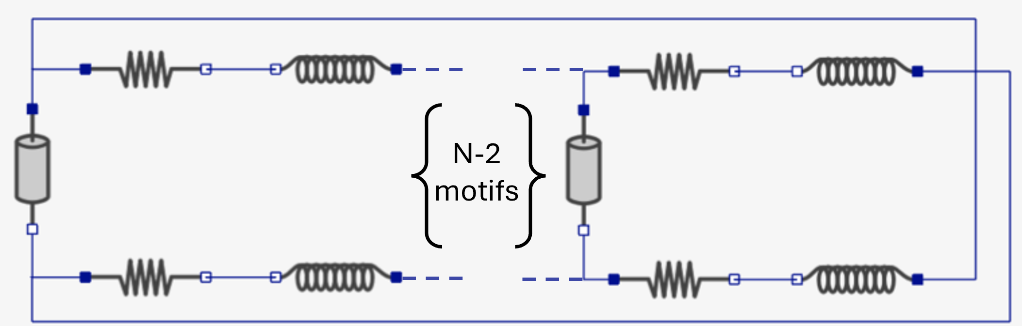

Squirrel cage: the two types of the electrical circuit closing
The electrical circuit of a squirrel cage can be closed in two ways, depending on the machine representation mode: modeling of a part (fraction) of the machine (1/4, 1/2, …) or of the entire machine.
Thus, the closing type of an electrical circuit is linked to the boundary conditions assigned to the frontiers of the correspondent finite element domain.
- cyclic closing if the entire motor is described or if the considered part is physically symmetric to the neighboring parts (an even number of the poles are represented in the finite element domain),
- anti-cyclic closing if the described part of the motor is physically antisymmetric to the neighboring parts (an odd number of poles represented).
The two types of the electrical circuit closing are represented in the figure below.
Cyclic closing: entire motor, symmetry (even number of poles)
Anti-cyclic closing: antisymmetry (odd number of poles pairs)
