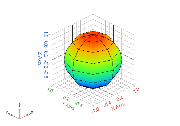

Plot a sphere with 10 segments:
figure();
sphere(10);
Figure 2. Sphere with 10 segments
