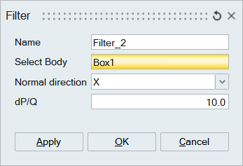

Filter is a Smart Object used to define a filter region to restrict dust particles in the air flow in/out in electronic systems.
  • Filters are used to remove dust, dirt, and other particulates from the air, preventing contamination and potential damage to sensitive electronics components.
  • In Electronics Thermal Management solution Filters are considered Smart Objects.
  • Filter should have a corresponding geometrical part in the 3D model
