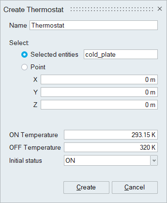

Thermostat is a Smart Object used control the temperature in electronic systems.
  • User can create a thermostat to track the temperature of a component or system and performs actions so that the component’s temperature is maintained within the desired limit.
  • User can create thermostat with Body, Face or Node as input.
  • ON and OFF temperature set the operating limits to the selected component.
  • User can set the initial status of the thermostat, whether it is ON or OFF.
