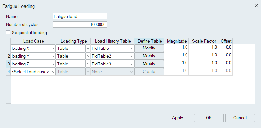

- Linear static or Non-Linear static solution without load cases.
- Linear static or Non-Linear static solution with load cases.

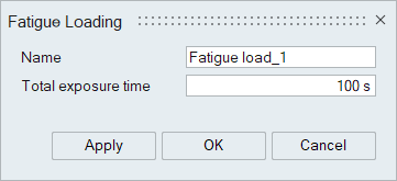

- Random response solution without load cases.
- Each fatigue load is equivalent to fatigue event in OptiStruct.
- The load history can be defined using predefined fatigue loading types or using user defined loading tables.
- The following predefined fatigue loading types are available.
- Fully reversed
- Zero based
- Ratio (Curve with loading ratio = 0.5)
