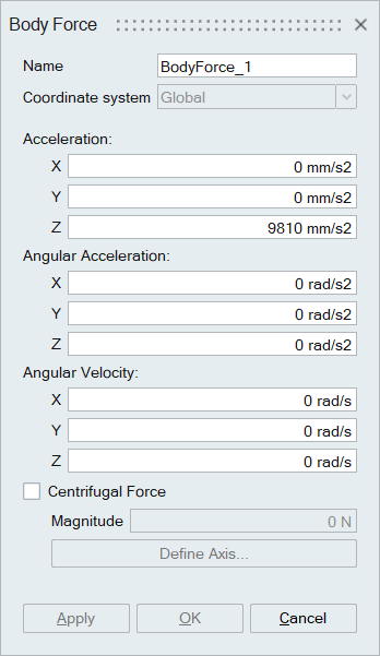

Body Force
This command is used to define the following
- Acceleration,
- Angular Acceleration,
- Angular velocities,
- Centrifugal forces.
- Body Force can be applied on bodies.
- Body Force can be applied with respect to a local coordinate system.
- The centrifugal force option is used to apply centrifugal force about the specified axis. This is supported only for Abaqus.
- For Abaqus, Body force can be applied on mass elements by selecting mass from LBC browser.
