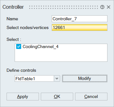

Controller regulates the mass flow rate of the cooling fluid in the cooling channel to maintain system temperature within desired limits.
The Controller adjusts the cooling fluid flow rate based on system temperature feedback. When the monitored temperature exceeds a defined threshold, the Controller increases the fluid mass flow rate to reduce the temperature.
Temperature Regulation: Users can select specific nodes or vertices where temperature control is desired.

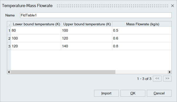

Define Controls: A control table can be set up to specify mass flow rates corresponding to temperature ranges, enabling dynamic regulation.
