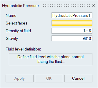

This tool is used to define hydrostatic pressure.
  1. Hydrostatic pressure is the pressure that is exerted by a fluid at a given point within the fluid, due to gravity.
  2. The wetting surfaces, density of the fluid, acceleration due to gravity and the fluid level are given as input.
  3. The maximum height will be computed internally and maximum pressure will be computed by the relation:
    P m a x = ρ × g × H m a x
    where
    P - Hydrostatic Pressure
    ρ - Density of the fluid
    g - Acceleration due to gravity
    H m a x - Height at which the fluid Pressure is maximum
