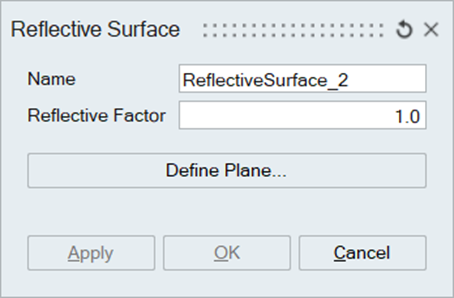

This tool is used to create reflective plane.
- Reflective surface is the plane or surface over which the sound gets reflected based on its position and reflective factor.
- Reflective Factor is a dimensionless quantity which defines the amount of sound reflected to the source.

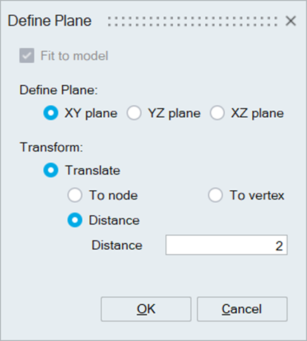

- Define plane is used to define the reflective surface as an infinite
plane. Here, the plane creation is restricted in such a way that the
creation is allowed only along the perpendicular planes and not in the
oblique planes.
