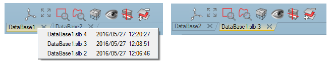

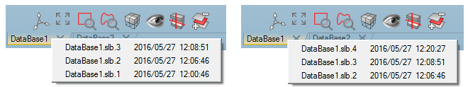

Auto Save
This option is used to save the database at the specified time interval. User can specify the location for saving the database. By default, database will be saved under scratch directory. Number of back up database can also be set.
Example
In this, time interval is 2 mins and backup count is 3.
Lists the saved databases with time stamp information in the tab right click. On selecting any one in that right click menu will close the current document and opens that database.

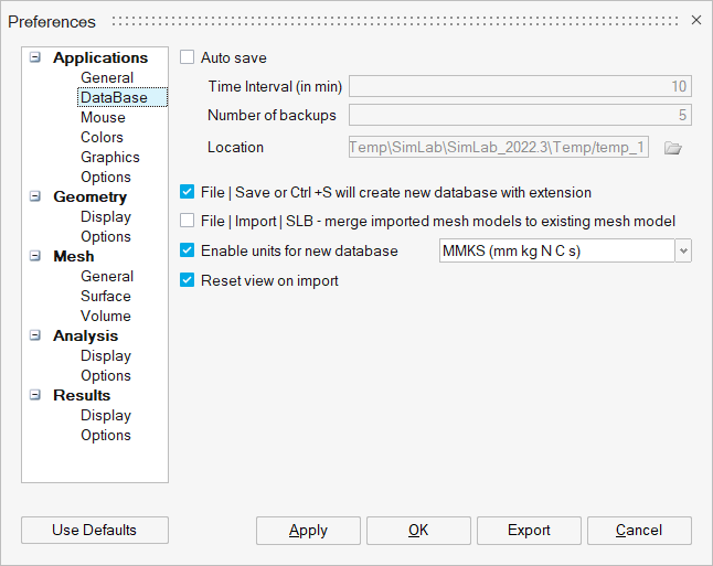

File | Save or Ctrl +S will create new database with extension
This option is used to save the database with new name or overwrite the database with existing name.
File | Import | SLB - merge imported mesh models to existing mesh model
Turn this toggle ON to merge the database (slb) being imported to the first existing mesh model.
Enable units for new database
This option is used to set the current display unit system for newly created database.
Reset view on import
Turn off this toggle to avoid the view reset on importing models in a non-empty database.
