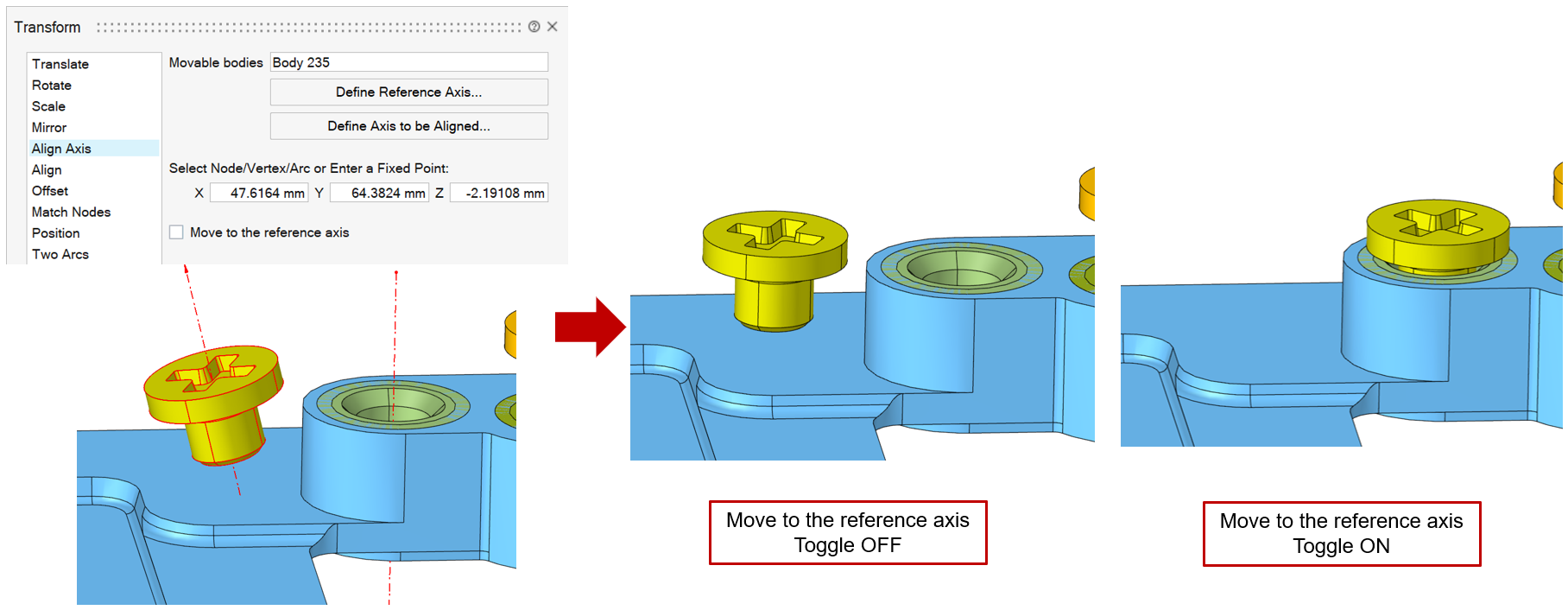

Move to the reference axis
Turn on this toggle to translate the given body to the reference axis after alignment.

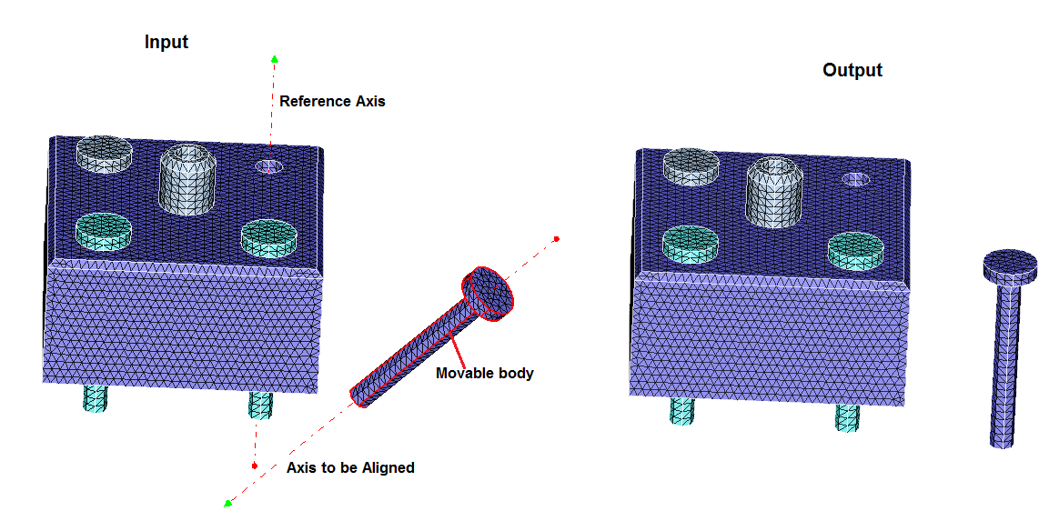

Example 1 (Single body)

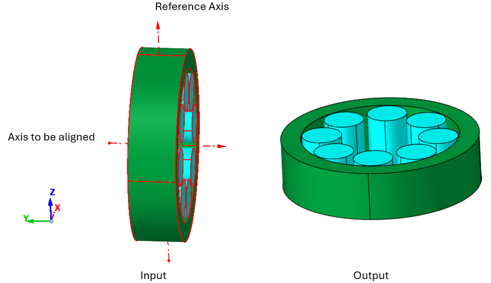

Example 2 (Multiple bodies)
Example 3 (Move to the reference axis)
