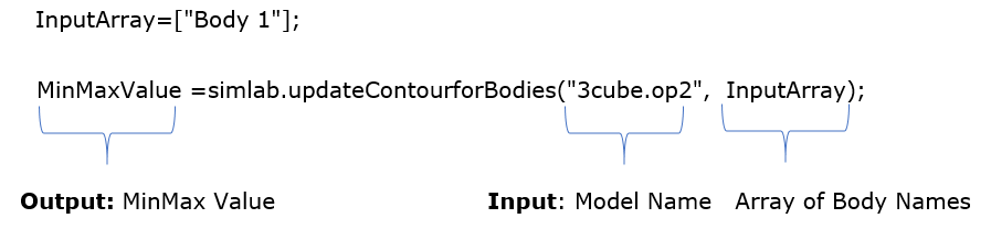

This utility is used to get the minimum and maximum result value and to update the contour for the given bodies.
Syntax
RinputBodyArray(Optional) = ["Body 1", "Body 2"];
MinMaxValue = simlab.updateContourforBodies("Model Name", inputBodyArray);
User Case

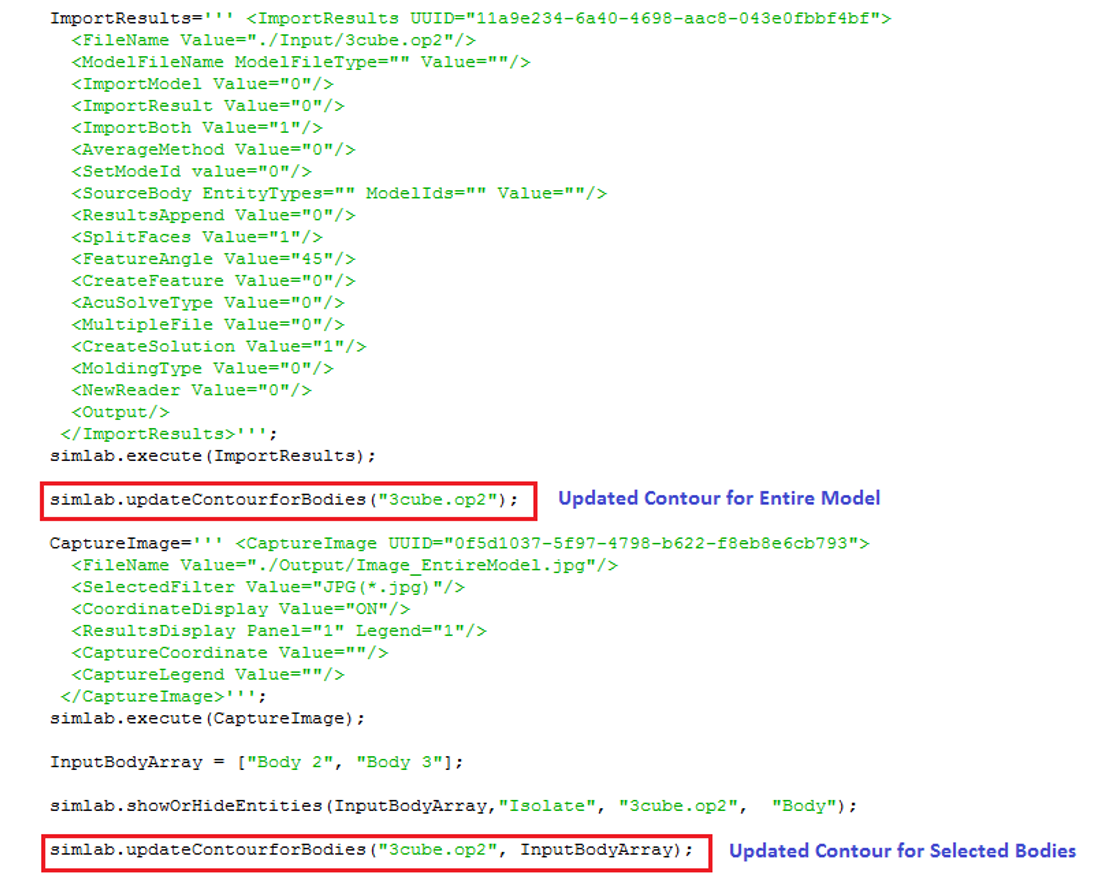

It can be used to update the contour for the selected bodies and we can capture them as an image for results comparison.
Utility Input/output
Note: If the Input Body Array is empty, it will update the contour for the
entire Model.
Sample
Note: Sample Script
