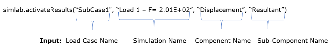

simlab.activateResults("LoadCaseName", "SimulationName", "ComponentName", "SubComponentName")

Utility Input/output
Note:
- If the LoadCase Name is empty, it will take the current load case
- If the Simulation Name is empty, it will take the last simulation

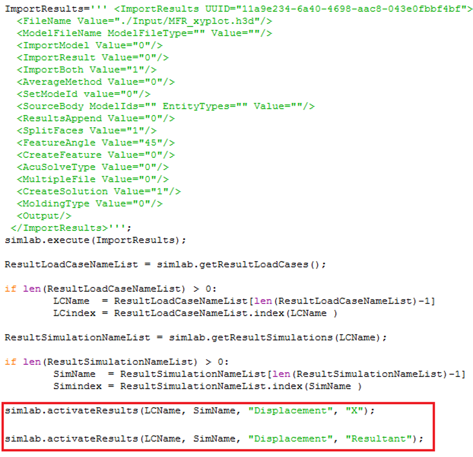

Sample
Note: Sample Script
