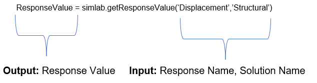

This utility is used to display the value of the response for the given solution. The input arguments are Response name and the Solution name.
Syntax
simlab.getResponseValue(‘ResponseName’,‘SolutionName’)
User Case
- This utility can be used to get the response value, which the user has created for the given solution. Here the value of the response will be displayed along with its units.

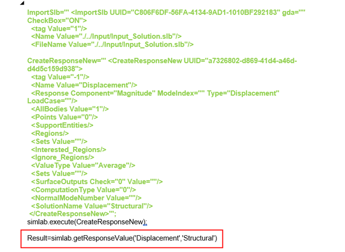

Sample
Note: Sample Script
