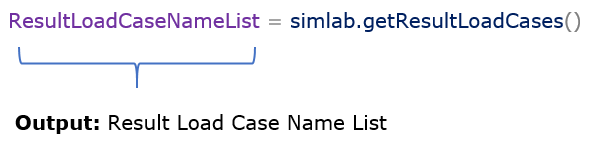

ResultLoadCaseNameList = simlab.getResultLoadCases()

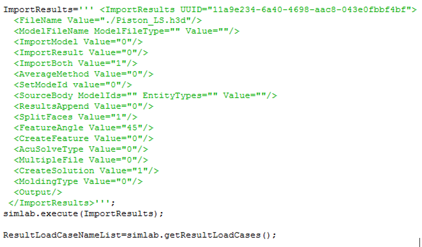

Sample
Note: Sample Script
