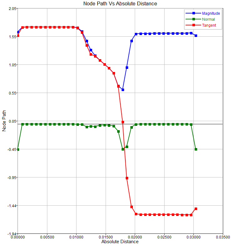

This utility is used to obtain the Magnitude, Normal and Tangential values in a CSV file format for a given node path. Additionally, we can save the Magnitude, Normal and Tangential plots as an image.

This utility is used to generate the normal and tangential plots of the defined node paths with various result components for the purpose of analyzing the results.

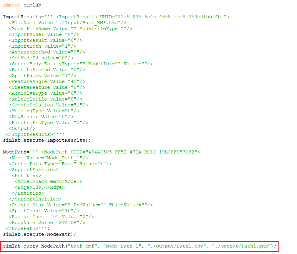

Sample
Output
Note: Sample Script
