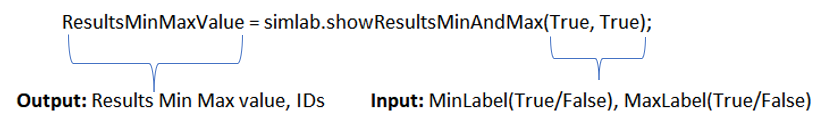

ResultMinMaxValue = simlab.showResultsMinAndMax("True/False", “True/False”)
Use Case
This utility can be used to display the minimum and maximum result values separately and capture them as an image for reporting purposes.
Utility Input/output

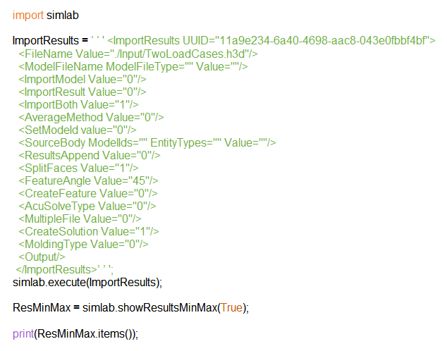

Sample
Note: Sample Script
