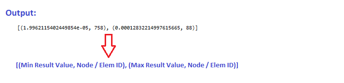

This utility is used to display the minimum and maximum results values in the graphics area and returns the minimum and maximum value along with its node / element Ids for the visible entities.
Syntax

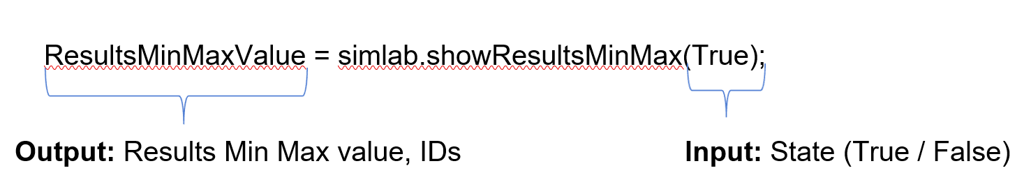

ResultMinMaxValue = simlab.showResultsMinMax("True / False")
Use Case

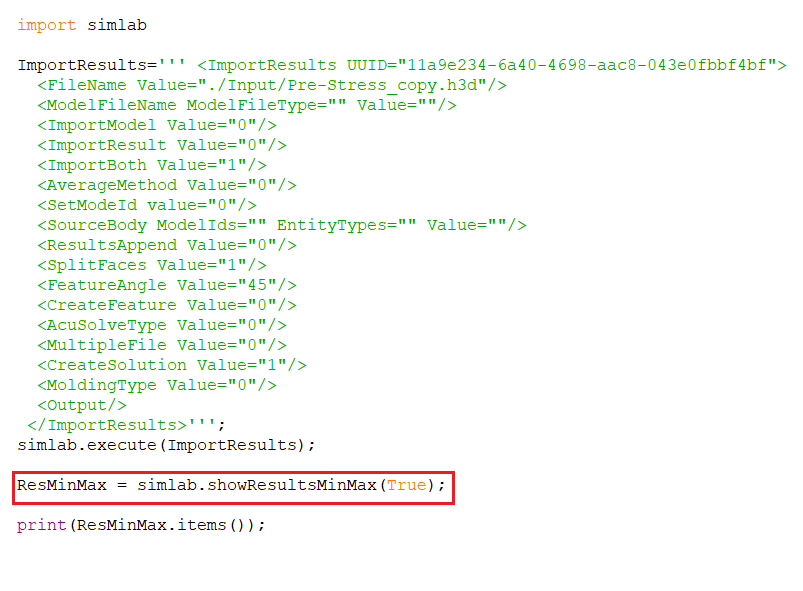

This utility can be used to display the minimum and maximum results value and capture them as an image for reporting purpose.
Utility Input/output
Sample
Note: Sample Script
