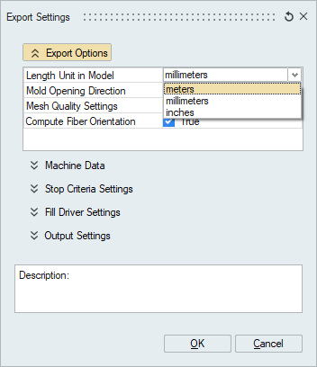

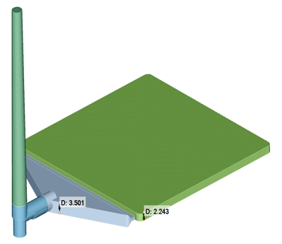

We can mesh a model in millimeter, inches or in meters. While exporting, we have to use same length unit that is used while meshing. For example, the following model is meshed in mm. While exporting, we have to use "Length Unit in Model" as millimeters. If by mistake, we select meters, then thickness with considered as 2.243 m instead of 2.243 mm and this will lead to incorrect results.
Best practices
  1. Before saving the export setting, verify length unit in mesh.
  2. Select appropriate length "unit in model".
