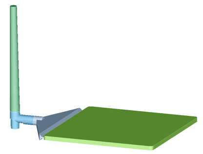

Models with multiple bodies will have interior face elements which should not be selected wall BC.
For example, The model below has 4 bodies. Between adjacent bodies there are interior face elements which should not be selected while creating wall BCs.

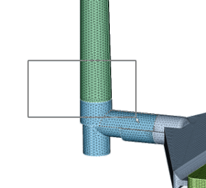

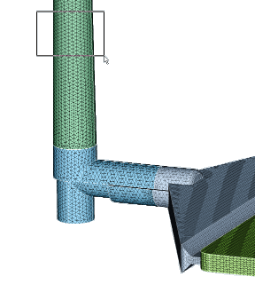

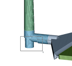

- Avoid window selection where interior face elements can get selected. Instead
select surfaces for one body at a time.

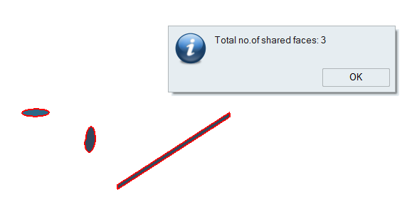

Avoid Best Practice
- Create face group of all interior elements and hide them.
