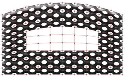

Conform a Lattice with a Custom UV Grid
Convert an existing surface parametrization or create a new one with complete control over the spacing/layout/position of the lattice unit cells to more easily map a lattice coordinate space onto a target surface.
