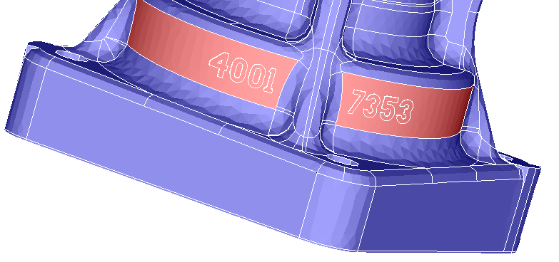

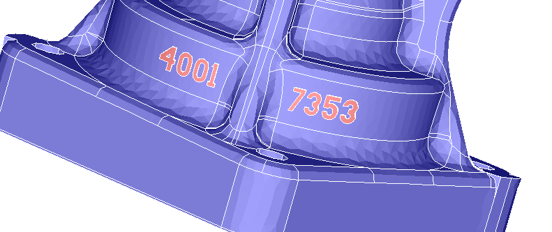

Example 1
This example shows how to collect the logo surfaces easily from a component. In SimLab, generally, logos will be preserved before generating surface mesh. Pick the logo's top surfaces as a guide and click the "Add" button. The adjacent faces connected to the topological edges of the guide face are selected.
Input

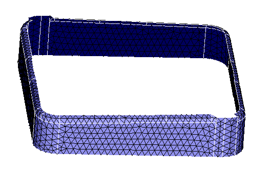

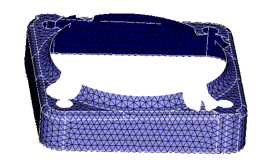

Example 2
This example shows how the group layer grows for the given group input.
Input
