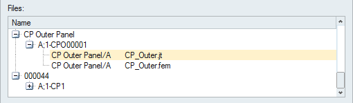

The results of the search query are displayed under
Files. Click the + on an assembly node to expand it.

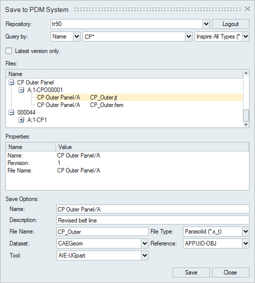

Select where to save the file.
- To save over an existing file, select the file. If the selected file name already exists in the PDM system, the version in the PDM system will be overwritten.
- To save a file with a new name, select the parent node where you want to save the file. The saved file will appear as a child under the parent.
- Under Save Options, enter a Name and Description for the file. The File Name defaults to the name of the file in Inspire.
- Select a File Type. Dataset, Reference, and Tool are filled in automatically based on the file type. (Teamcenter only; Windchill does not have the Dataset options.) You may need to change these values depending on the requirements of your PDM system.
- Click Save.
Tip: When uploading to Teamcenter, the file type that you want to upload
should match the selected dataset type, tool, and file reference in the Upload
dialog. Otherwise you will receive a "no named reference" error, which means that
the dataset was created in Teamcenter but doesn't reference the file.
