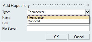

Select .
Add a repository.
For Type, select Teamcenter or Windchill.

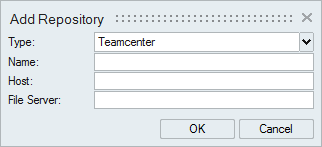

- Enter the Name, Host, and File Server.
- Click OK.
