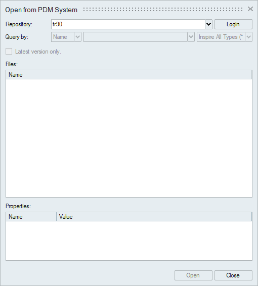

Select a repository.
- Click Login and enter your credentials to log in to your PDM system. If you're unsure what your credentials are, check with your network administrator.

The results of the search query are displayed under
Files. Click the + on an assembly node to expand it.
Properties are defined in your PDM system and are for display only.
- Double-click a file to open it, or select it and click Open (or Import). Select a node to open an entire assembly, or a single file to open a part.
