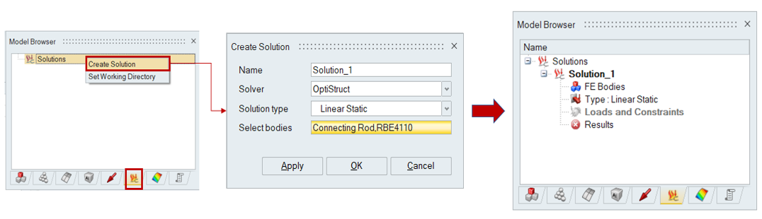

Step 9: Create Solution
  1. Go to Solution Browser > Right click > Create Solution.
  2. Select the Connecting Rod FEM body and RBE body in graphic area.
  3. Define the solution parameters as show in below picture and click OK.

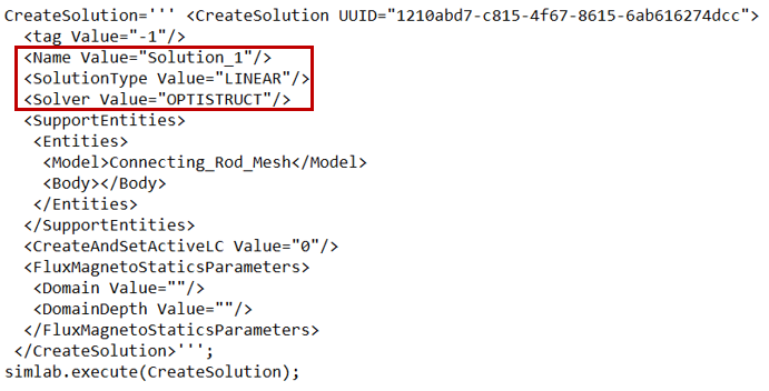

  4. This will be recorded in script as below.
