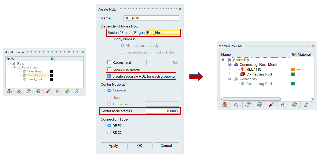

Step 8: Create RBE
- Go to Analysis > Loads and Constraints > Connectors > Create RBE.
- Select "Bolt_Hole" face group from Group browser and define RBE creation parameters as

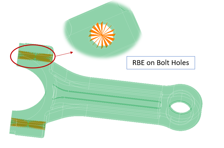

shown in below picture. Then click OK.

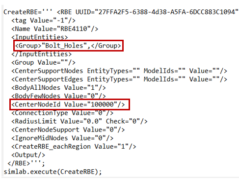

- The operation is recorded as below.
