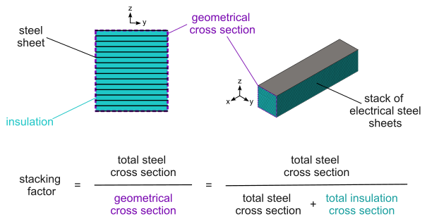

    The sheet lamination is said to be laminated because it automatically accounts for the effect of the insulation of the electrical steel and for the small air gaps between the sheets in a stack. This is achieved through a homogenization procedure implemented. The overall effect of this homogenization is that the effective cross-section of magnetic material available for the magnetic flux to traverse in the region is reduced. The reduction factor is known as the stacking factor of the region, and corresponds to the total cross section area occupied by magnetic material (steel) in the stack divided by the surface area of the geometrical cross section of the same stack (i.e., the total cross section area, including the insulation and air gaps between sheets). This definition is illustrated below:

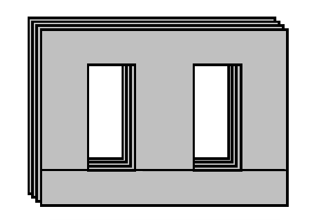

Sheet laminations are often used in magnetic circuits of transformers and of some electrical machines in order to reduce Eddy current losses. Here is an example of laminated transformer:

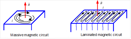

The eddy current distribution is shown on the following image for both Massive magnetic circuit and Laminated magnetic circuit:

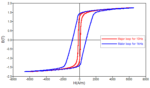

Magnetic losses and hysteresis cycle:
In practice, magnetic materials are characterized by their hysteresis cycle and the magnetic losses can be represented by this cycle, as presented below:
  • the volume energy created by hysteresis losses is corresponding to static hysteresis cycle (f<1Hz).
  • as the frequency increases, the cycle area increases and the volume energy created by Eddy current losses is corresponding to the difference between the dynamic hysteresis cycle area and the static one.

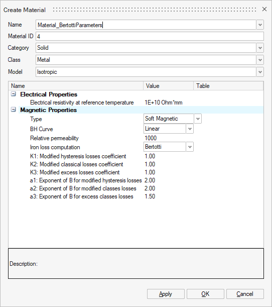

To be able to compute the iron losses in SimLab, the material assigned to the body defined by a sheet lamination load should be a soft magnetic material with 3 coefficients and 3 exponents of Bertotti Model.

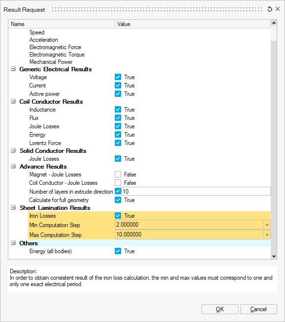

  • For 2D and 3D Transient Magnetic solutions, in Result Request, in Sheet Lamination Results node, you should choose True for Iron Losses computation and define the min and max steps to define the exact electrical period.
    Attention: In order to obtain physically meaningful results, the user must choose the correct time interval. The user must select a time interval corresponding to one and only one electrical period of the device.
    Note: The first two time steps of a scenario can not be selected for the time interval definition and are hidden from the list.
    Note: Flux solver interprets the provided time interval as a full electrical period. More specifically, Flux solver checks the periodicity of the magnetic flux density B(t) by comparing its values at the first and last time steps of the selected interval. Then, if the periodicity tests fail, Flux solver displays a warning message, but the computation is nevertheless carried out.

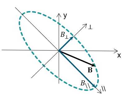

  • and are the maximum excursions from their continuous component, of the longitudinal and the transversal projections of the homogenized magnetic flux density over the period T , respectively; in each point of the laminated region, the longitudinal direction is defined as the direction of B at the time step where the magnetic flux density reaches its maximum value during the considered period, while the transversal direction is orthogonal to the longitudinal one, as shown in the image below;
  • is the magnitude of the time derivative of the homogenized magnetic flux density, which has been beforehand decomposed into its longitudinal and transversal projections defined here above.

    1. a Soft Magnetic Material should be assigned to the body. To compute the iron losses in transient and AC analysis, the Bertotti parameters should be defined.

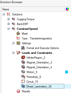

    → The sheet lamination is created and appears in the Solution Browser in the Loads and Constraints node.
  6. To compute the iron losses in Transient and AC analysis: before solving, edit Result Request and define the Sheet Lamination Results
    1. Choose True for the Iron Losses
    2. For 2D and 3D Transient Magnetic solutions, define the interval: Min Computation Step and Max Computation Step
    3. Validate by clicking on OK
