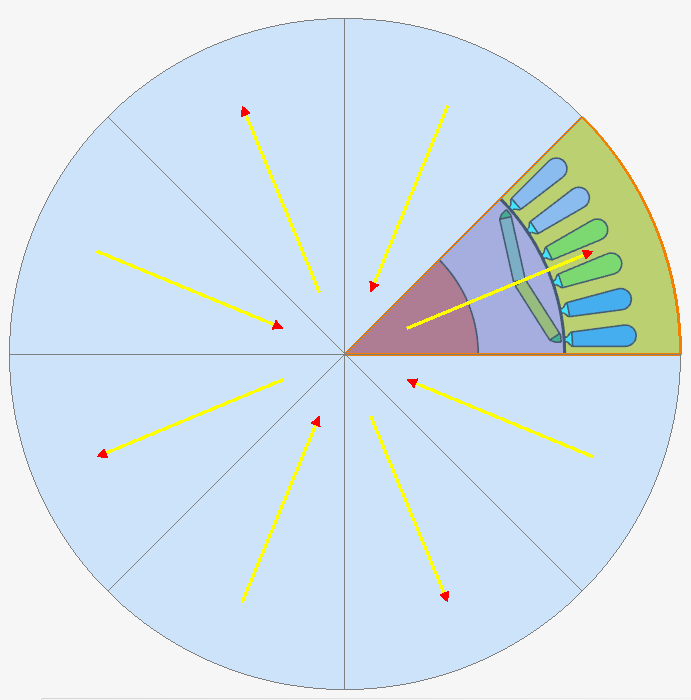

Periodicity conditions on boundaries
When a device has repetitive patterns, it is possible to model a fraction of the device (the basic pattern), and to impose appropriate periodicity conditions on the periodicity planes.
From a physical point of view, periodicity boundary conditions are set via the state variable (potential).
Even periodicity
(or cyclic or periodic)
Odd periodicity
(or anti-cyclic or anti-periodic)
Identical values of the variable on the homologous nodes Opposite values of the variable on the homologous nodes

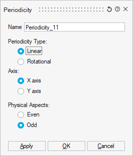

Two types of periodicities exist :
  • Linear:
    The periodic part is repeated by translation along an axis.
    A typical example is a linear motor.
  • Rotational:
    The periodic part is repeated by rotation around an axis.
    A typical example is a rotating motor.
Table 1. Linear and Rotation Periodicity dialog boxes:
Linear Periodicity Rotational Periodicity
  • Geometrical Aspects:
    • Axis
      • For Circular Periodicity, the periodic axis will be always Z axis.
      • For Linear Periodicity, the periodic axis can be either X or Y axis. The periodic portion is repeated linearly on the selected axis.
    Note: It is mandatory to have identical geometry and mesh between these two boundaries. For more details on the boundary mesh, please refer to Motor Mesh.
  • Physical Aspects
    This option is necessary to define the physical definition in the non-represented portions.
    There are 2 possibilities:
    • Even i.e. cyclic
    • Odd i.e. anticyclic
