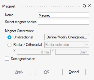

Dialog Box
  • Select magnet bodies: Select one or several bodies to define as a magnet.

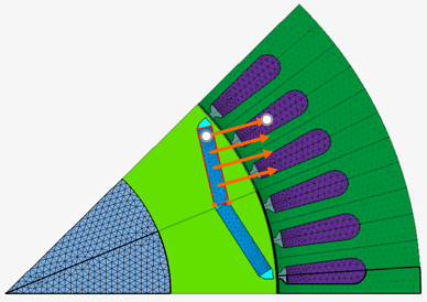

  • Magnet Orientation: two choices

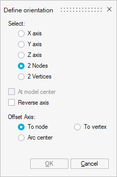

    • Unidirectional: along a vector to define by clicking on Define/Modify Orientation

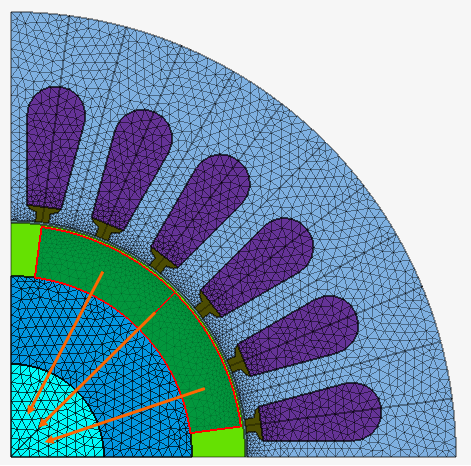

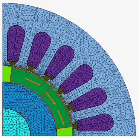

    • Radial / Orthoradial: Magnetic direction of the selected body either diverge/converge from the given point
      4 types:
      • Radial outwards
      • Radial inwards
      • Orthoradial clockwise
      • Orthoradial anticlockwise

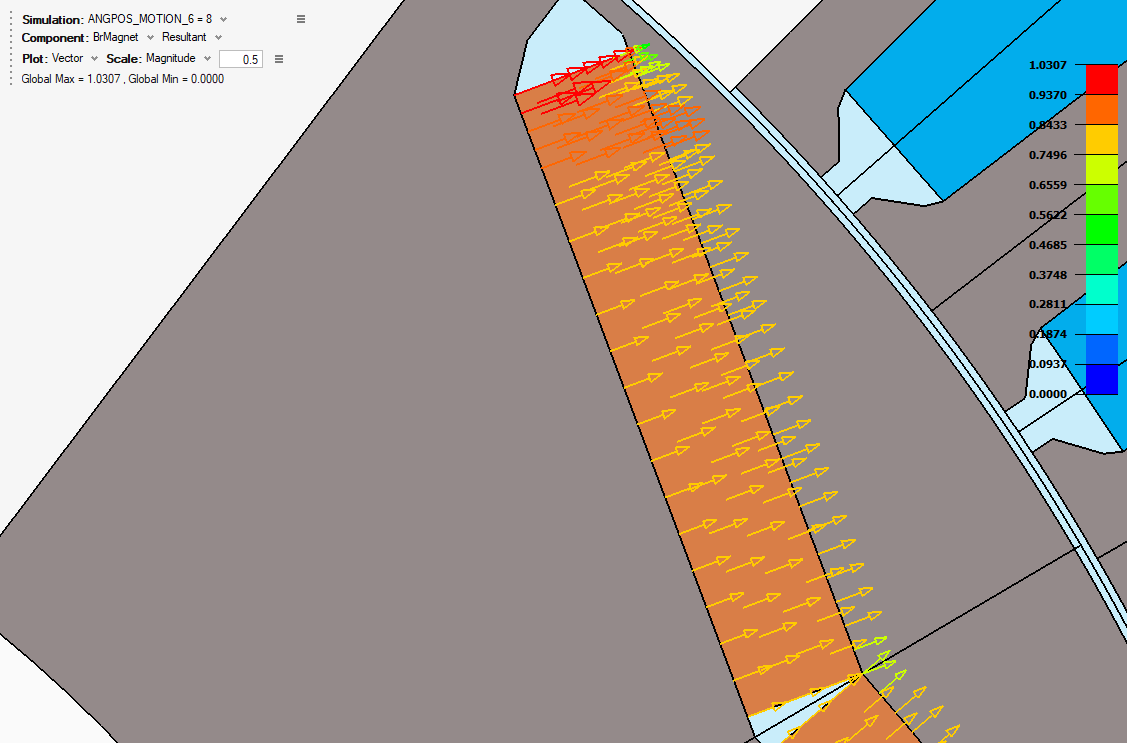

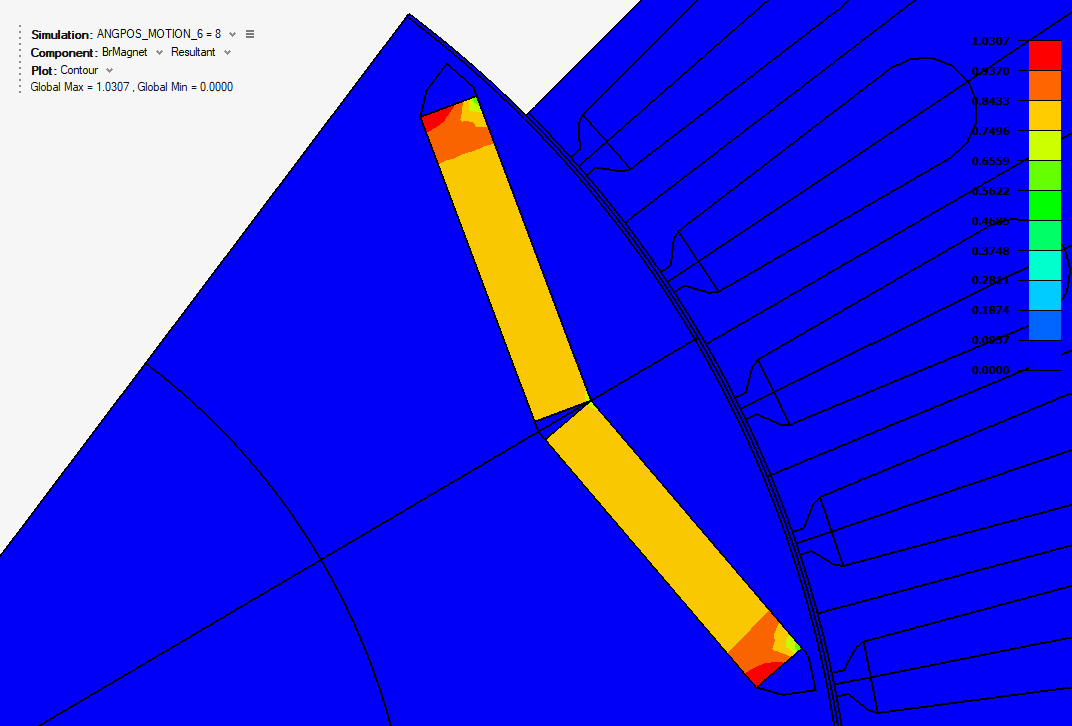

The vector quantity BrMagnet available, has the advantage of containing the explicit direction and orientation of the remanent field.
Here is an example of the postprocessing of the vector quantity of the demagnetization (BrMagnet) in the magnet part:
module of vector quantity BrMagnet vector quantity BrMagnet (direction and orientation of the remanent field)
