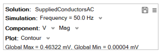

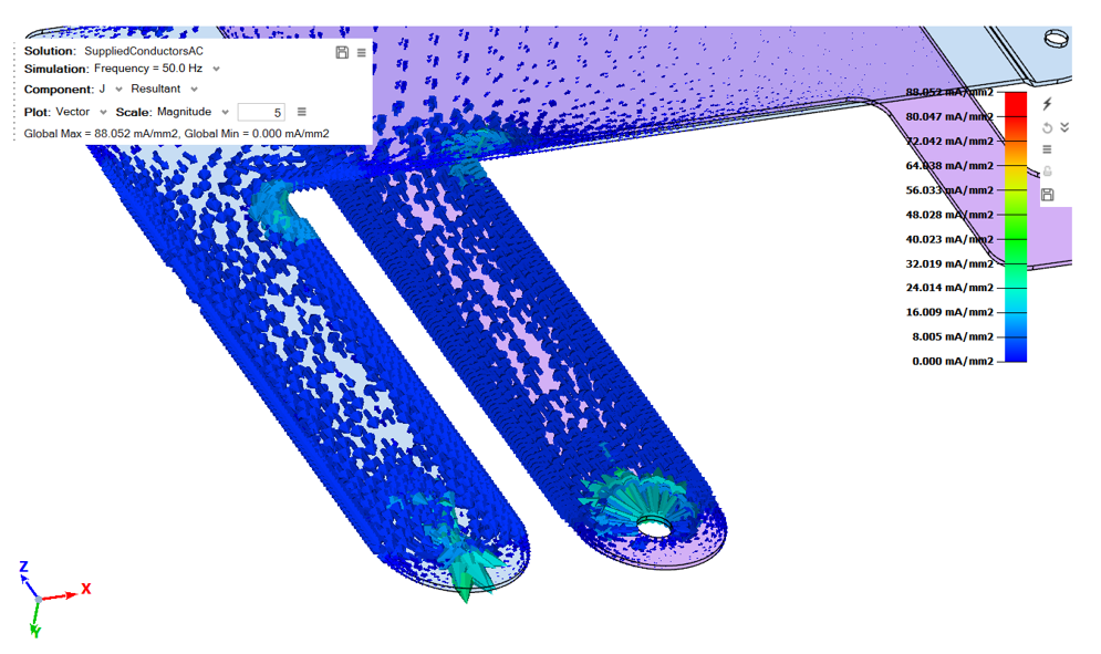

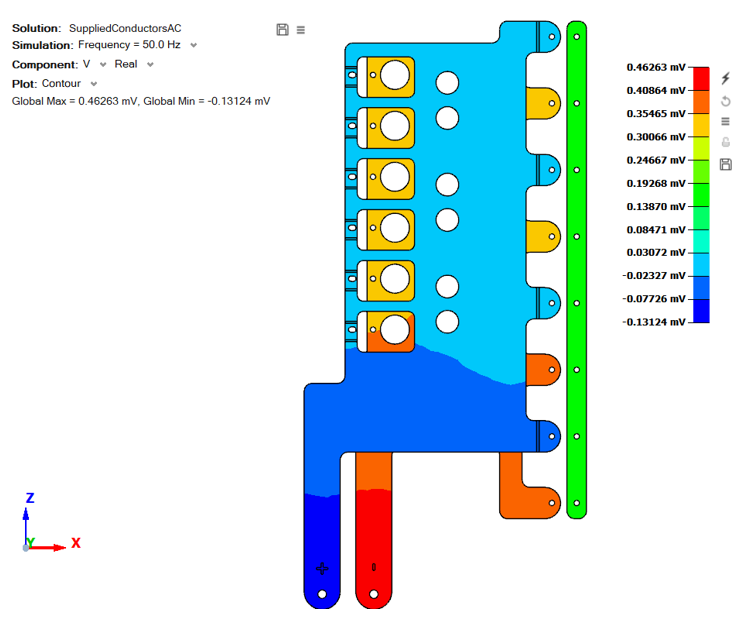

At the end of the solving, the contour results are displayed automatically. The contour or arrows and isoline options are visible on the graphical window top-left part.

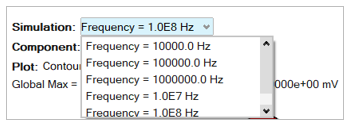

  • The Simulation allows selecting the current Frequency step.
  • The possible Components for an AC Supplied Conductors solution are the current density J, the electrical potential V, and the Joule losses HEATLOSS_JOULE.
  • The Plot allows to choose between contour or arrows:
    • to display the color shade, choose Contour
    • to display the arrows, choose Vector
    • to display the isolines, choose Iso Line

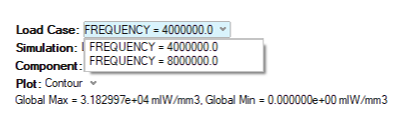

Animation can be performed for multi-frequency results using the bottom animation toolbar:
In case of the use of Motion LBC with various frequencies, the results are sorted as follows:
  • Load Case to select the frequency step:
  • Simulation to select the motion step:
Transient animation mode refers to the motion steps in this case:

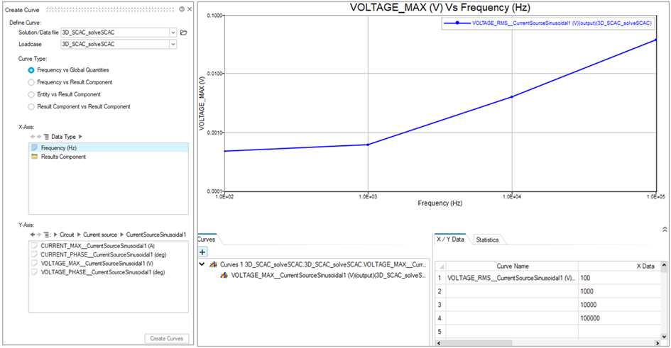

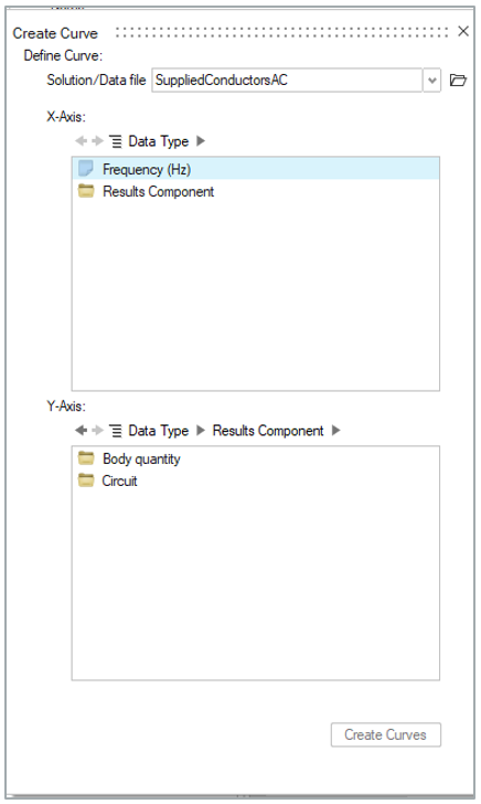

XY Plot
Results > XY Plot
The XY Plot allows the user to do point computations.
Note: For more details consult XY Plot.

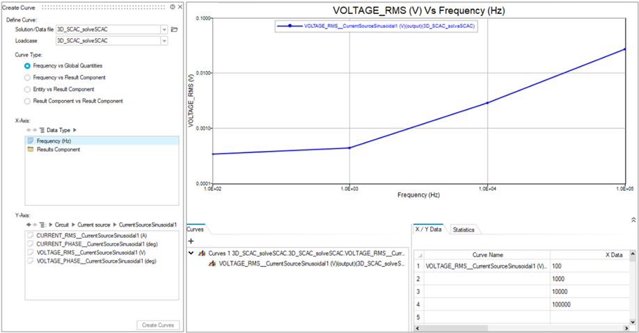

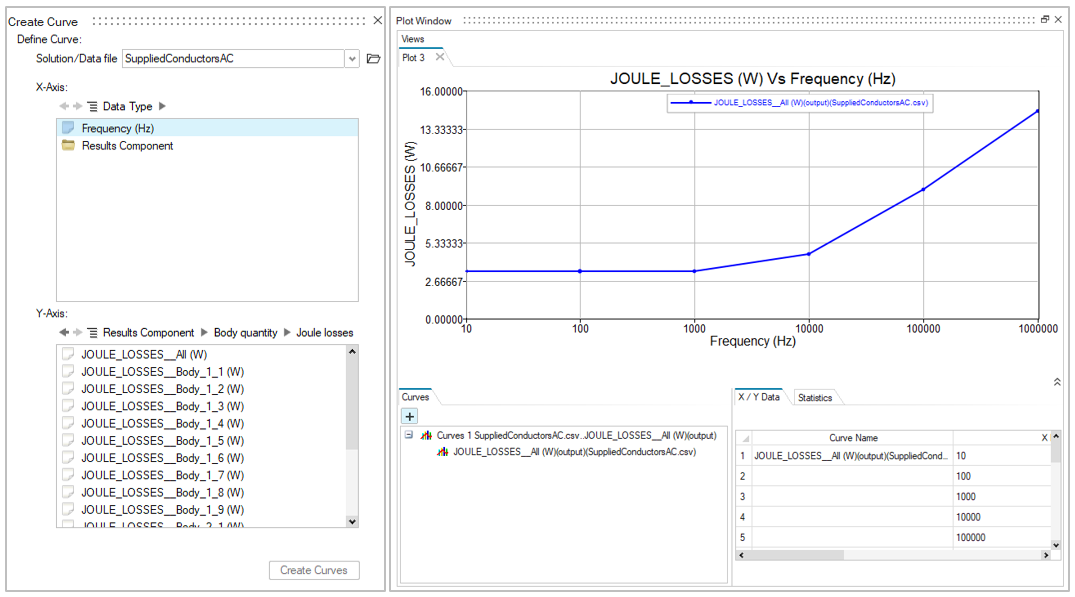

2D Plot
Results > Plot
The 2D Plot allows to post process the default global quantities and the chosen ones in the Result Request dialog box by the user.
For the SCAC solution, the quantities that can be post-processed are grouped by category:
  • Body quantity (Joule losses)
  • Circuit (current, voltage of electrical components)
Examples of 2D Plots:
  • In the Body quantity category
  • In the Circuit category
    • RMS values
    • Max values

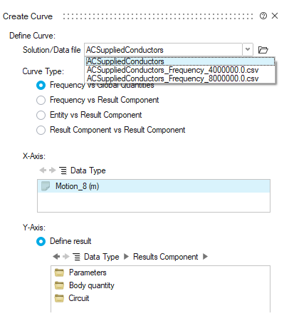

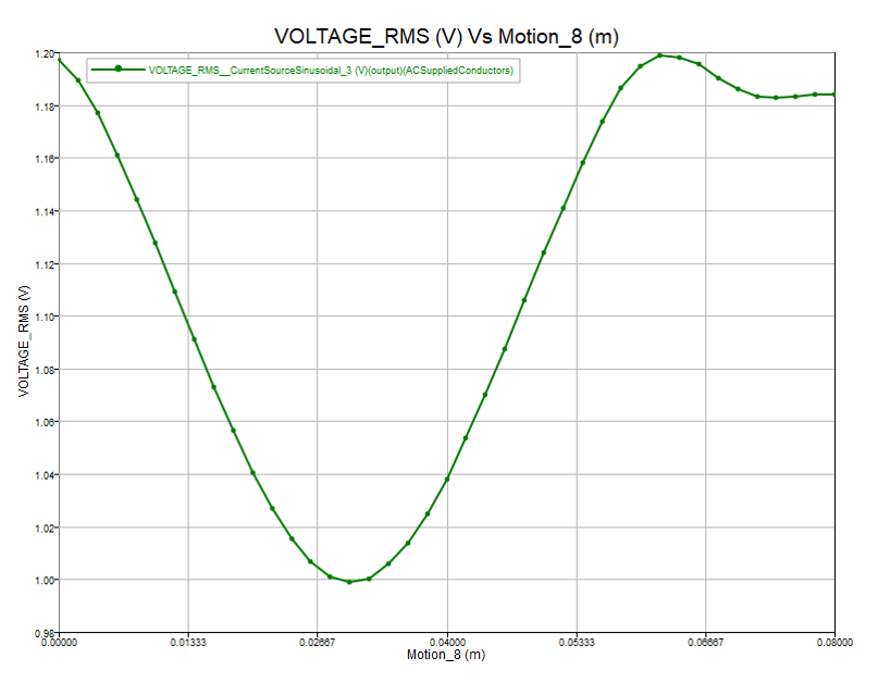

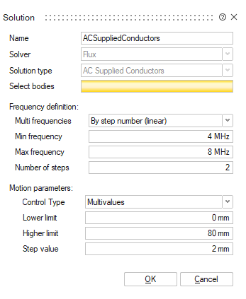

      For scenarios with motion in AC Supplied Conductors’ simulation, the X-Axis parameter in 2DPlot results is the motion values in meters for translation, and in degrees for rotation.
      In case of double scenarios, e.g. parameter variation in motion and also in frequency (see solution definition below), the 2DPlot has various csv files to load.
      The rule in that case is: One csv file per frequency.
      For each csv file, the variation parameter is the motion parameter. You can select the frequency result using the Solution/Data File combo-box.
      Then we can plot the variation according to motion values.
The created 2D Plot are saved in the Solution Browser in Plots.
