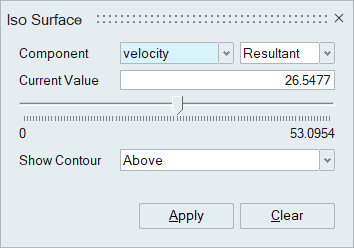

Iso Surface
Select the results component that should be used to calculate the iso values from the Result type drop-down menu and select a data component type from the second drop-down menu selection. Use slider to adjust the iso value

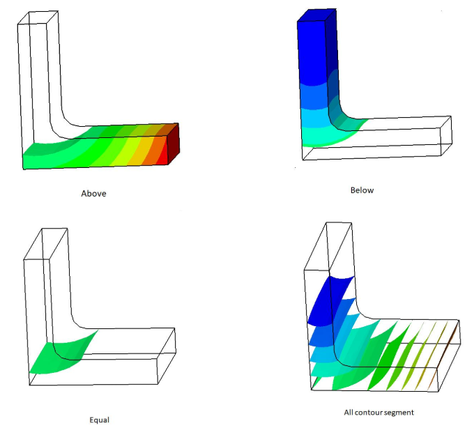

Show Contour Options
- Above - Updates the contour display with result values above the current iso surface value.
- Below - Updates the contour display with result values below the current iso surface value.
- Equal - Updates the contour display which is equal to the current iso value for solid elements.
- All contour segment value Updates the contour display for each legend bar interval values.
