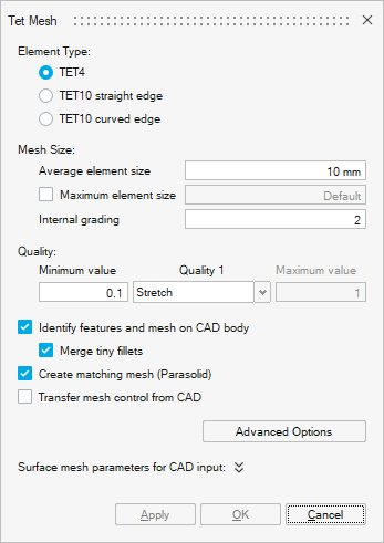

- Click on the Tet Mesh button in
Mesh ribbon:
- For example, in our contactor project, we choose a 1st order mesh
(since we chose 1st order mesh elements for Mesh
Controls and for Surface Mesh) with
tetrahedral elements:
In Element type, check TET4.
- In Mesh Size, in the Average element
size field, enter 2 mm.Tip: For the Average element size, you can set about the same size as the one for the surface mesh or a little larger.Important:

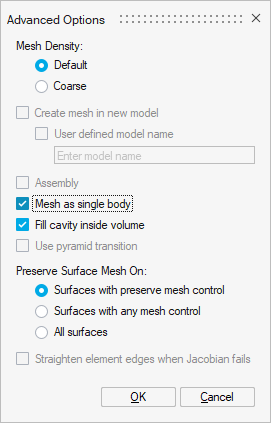

- Click on the Advanced Options
button.
By default, as the solution is a 3D Transient Magnetic one, the Mesh as single body option is checked, you can verify it.
And click on the OK button.

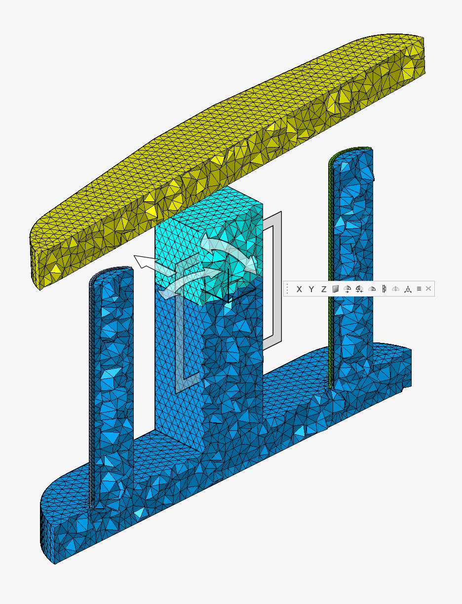

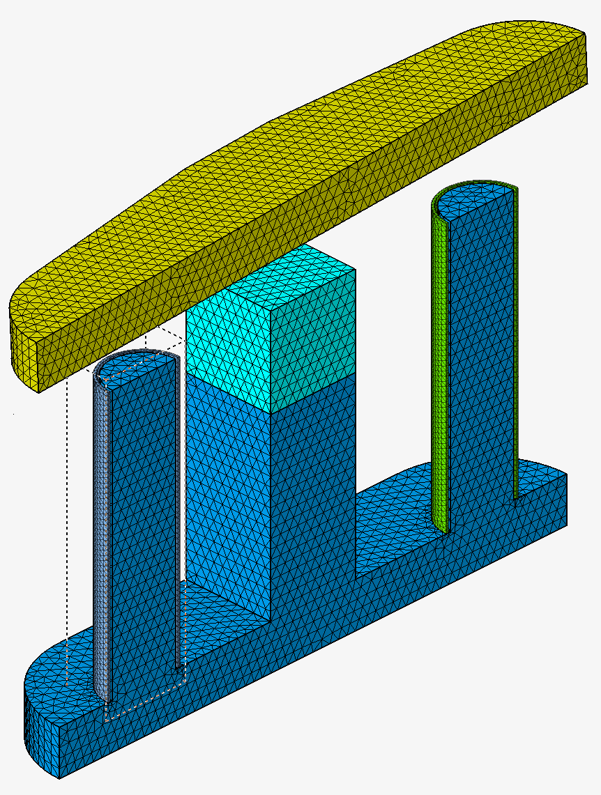

The volume mesh is generated.
To visualize the mesh inside the bodies, you can use the Enable Cutting Plane icon
located at the bottom of the graphic
window.

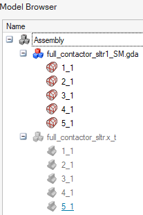

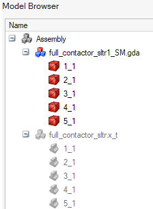

To the left of the graphic window, in the Model Browser, in the 1st tab Assembly, there are both models:- .gda (meshed bodies) with all bodies visible and the body icon corresponds now to a volume mesh.
- .x_t (CAD model) will all bodies invisible.

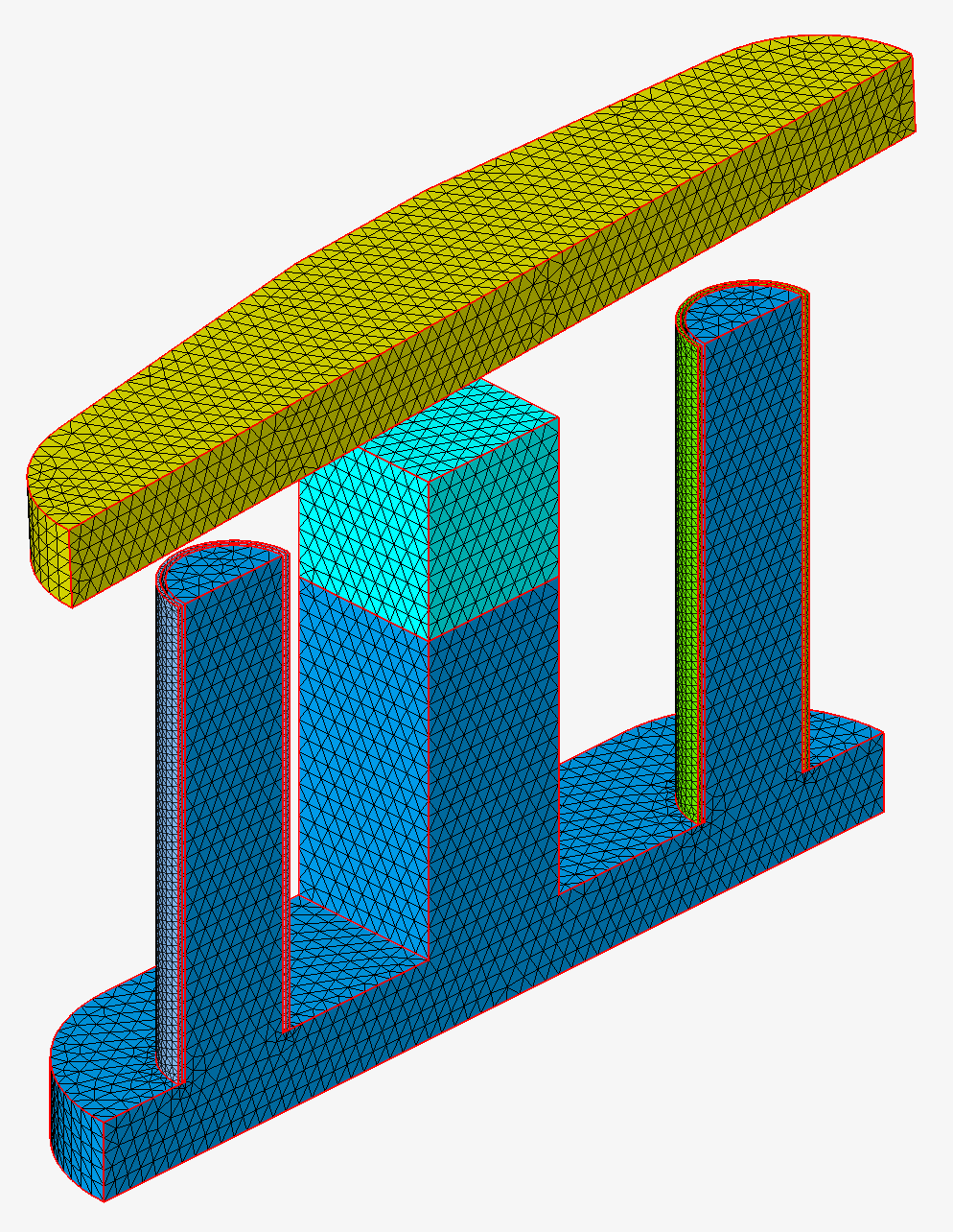

Before Tet Mesh After Tet Mesh
